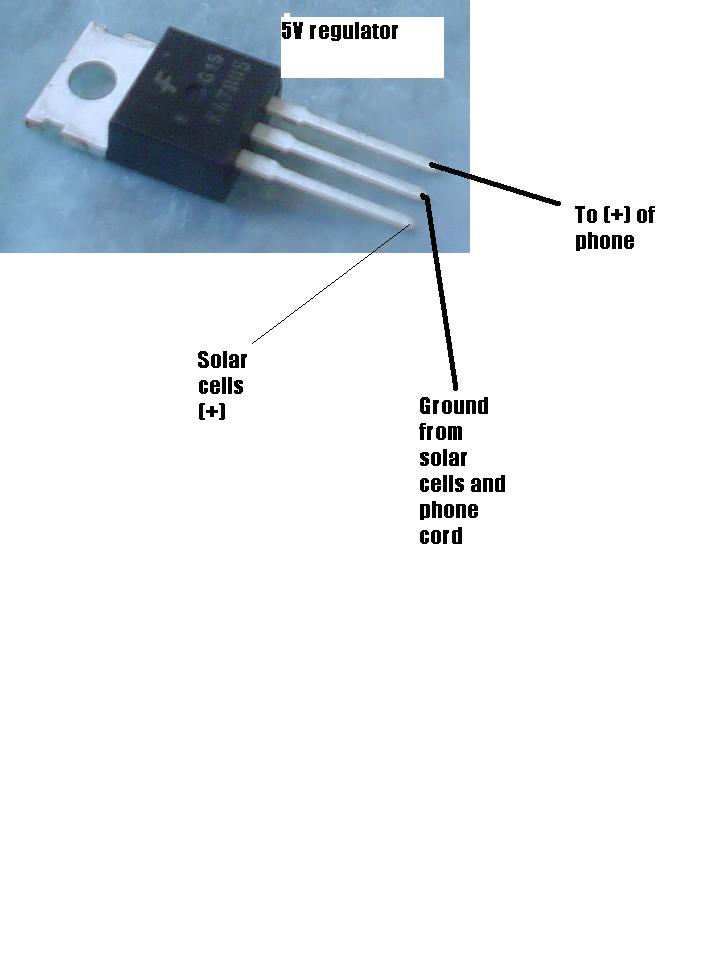

i made a picture to help you out
the parts are only
solar cells
LM 7805
some wire
perf board (optional)
the caps are optional but are good to have(you dont have to have the exact values)
Thank you very much for the picture! Now I get it. So I connect the ground wire from both the solar panels AND the phone to the common pin?

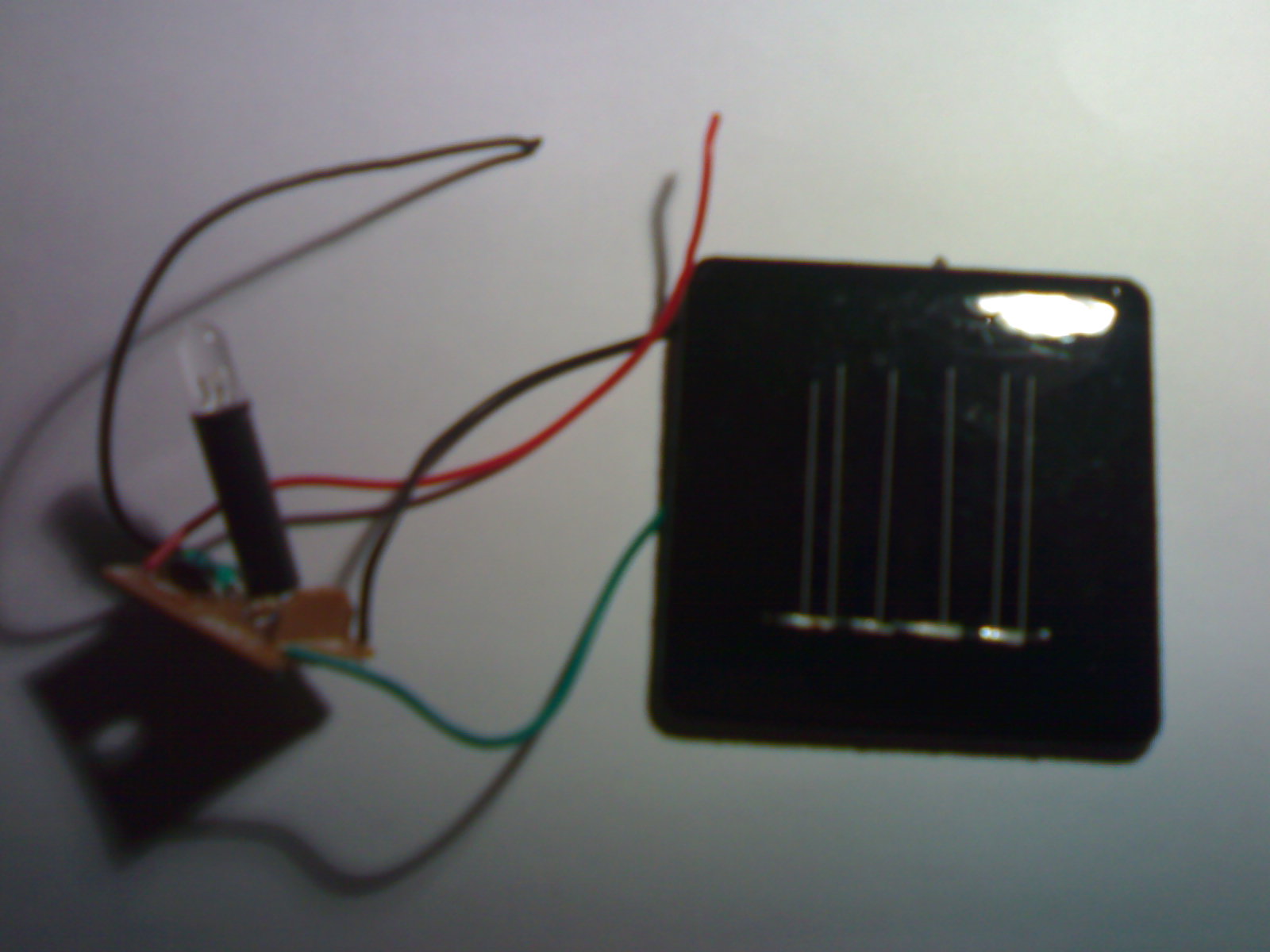

@whiz115 - that is almost the same! The panel is identicle, but the circuitry is a bit different. Mine has the LED practically flush with the circuit board, and I also have a on the board. Each solar has it's own board.
i knew it... ;)
also the battery must be green and says "NI-MH 1,2V AA 600mAh"
small world huh? where are you from?!
