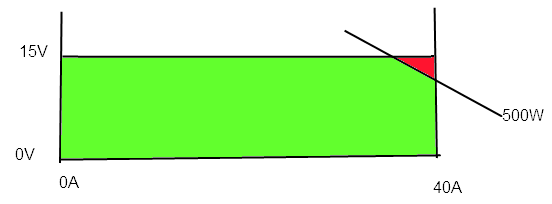

I have got one last confusion about charge controllers doesn't matter whether it is pwm or mppt.
Thing is i have seen many CC with variety of output amps on 12v and 24v with different manufacturers... But they are all different..
Which number in a charge controller defines that how many panals can be connected to it..?

Where did 18.9 come from?
12v X 40a = 480w which is close to 500 watts.
I think the voltage to charge a "12V" battery is 15V.
Sorry for the funny graph below.
Voltage 0 to 15V
Current 0 to 40A
Watts 500 max
Must stay in the green area. Where the voltage is less than 15V and the current is less than 40A and below the 500W line.
Can not get in the white area or the red area.
Start out with a low battery.
V=11, A=40, W=440.
V=12, A=40, W= 480.
V=13, A=38, W=500.
V=14, A=35, W=500.
V=15, A= 33, W=500.
Now the battery is almost full.
V=15, A=20
V=15, A=10
V=15, A=5 (trickle charge)

Thanks for the neat graph.. it helped...
18.9v is the panal voltage... I forgot in pwm power is wasted a lot... so 18.9 would become same as battery voltage once connected to it.
Won't the battery will be fried if charged till 15v?
Also How will you explain 12v 40A and 750Wp?
The only reason i can think of is panal efficiency.
750Wp would be about 560W
Probably the battery is like a car battery. The regulator limits the voltage to 14.5 volts. (more or less)
If you have a car with a real voltage meter on the dash; In the morning the battery voltage is 12V and full charged. When the motor is running well (charging) the voltage will charge to about 14.5V.

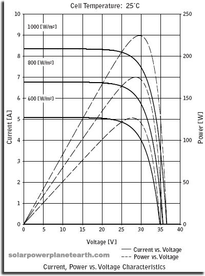

MPPT: Maximum Power Point.
This a controller that works to get the max power out of a panel.
This graph shows three light levers. 1000, 800, 600. Note at room temperature.
>If you short out a this panel it will only give you 6.8A at 0V =0 watts at 800 W/m2
>If you open up the wires you get 0A at 36V = 0 watts
>The MPPT is at 6A X 28V = 168W.
>This point moves with temp. and light.
>A MPPT controller works to find this point and pull the right voltage and current from the panel. Probably checks every second.
This panel could be used with a 24V battery with out a controller because the charge voltage will be in the 24 to 31V range which is close to MPPT. If this panel was used on a 12V battery the voltage is all wrong and you need a controller. At 12 to 15V you can only get 1/2 of the power out.
