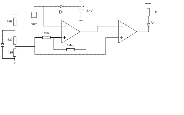

I am trying to make my own solar powered garden light using a 4.5v 60mA solar panel incorporating a comparator with hystereis. The circuit works well, as the light level falls to a certain threshold the LED turns on. The solar panel charges the battery as well as acts as a sensor to turn the LED on.
My problem is as the battery slowly decreases the turn on time of the comparator drifts. I was thinking of using a zener diode to establish a constant reference voltage to the input of the comparator but since the desired turn on time of the solar panel is so low at around 0.15v a zener cant be used to establish a threshold.
I don’t know how clear this is but can anyone suggest anything?
I have included a attached drawing.
Thanks.

Hi, Its possible to split R1 into two resistors.
At the junction of this split you could use a 1N4148 forward biassed diode to give about 0.65V.
Select R1A and R1B to give about 2mA thru the diode and then adjust R2 to that you get the Vref 0.12V
Do you follow OK.?:)

Do you mean like what i have attached?

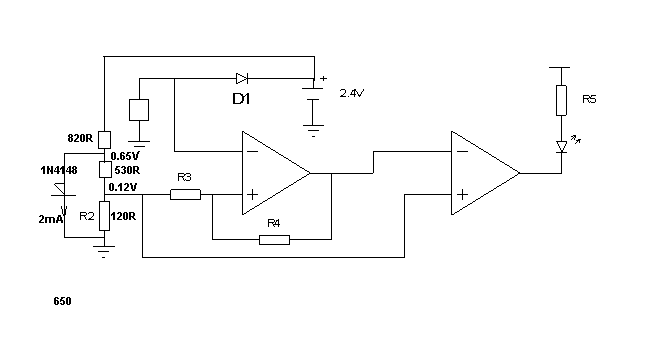

No,
Look at my dwg changes made to your original dwg.:)
EDIT:
your diode is the wrong way around.
Added some values, check the calculations.;)

If you have a 1K pot, make that R1b [530R] adjustable, it will give you more control. OK.:)

I tried the circuit. But unfortunately the LED does not fully saturate instead it gradually turns on im not sure but im guessing it has to do with the current through the diode not being proportional when the comparator switches.

hi al,
Problem solved.:)
Missing resistor from pin #1 to +V added a 3K9.
Remember the outputs of the LM393 are open collector.
The circuit works fine, used a 1K pot to simulate the solar panel.
Had to use +5V for test, no 2.4Vbty on the bench.
I used a 1K pot inplace of the 560R, set the Vref at 0.12V
You are operating the LM393 very close its lower limit at 2.4V.
EDIT: connect a 10K from the solar panel to the LM393 pin #2 [not a direct link]
Added extra components to the circuit.:)
