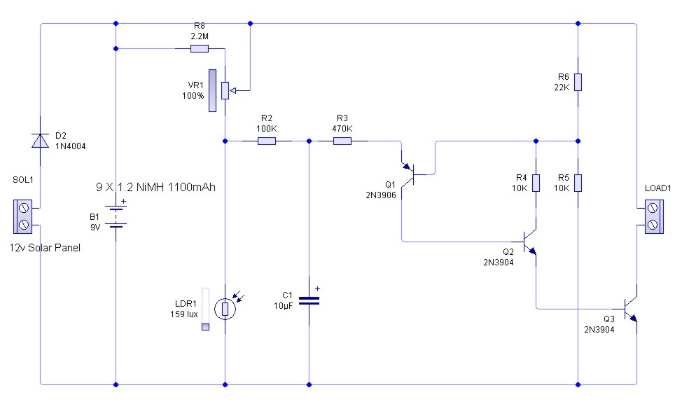

I should have a similar project completed and installed this weekend. The attached schematic will switch the load on at night, and off in the daytime. The 10.8 volt battery pack (they were handy) is simply charged through a diode, no over-charge protection is provided. The batteries are 1100 mAH, the solar panel is 100 mA, figure it should take 10 hours of full sunlight to overcharge the batteries, not too likely.
The Solor Panel is made from 4 X 6v 100mA cells, about $5.00 each at American Science & Surplus. The load can be anything 10 volts or less, in my case its an RGB LED fader.
The parts aren't too critical, should breadboard it first to experiment with. The LDR (CdS photo cell) might need some adjustment, that's what the 2.2 meg resistor and trim pot are for, you'll want it to be able cleanly switch at night/day.
I modified this circuit off the web, it's better than a previous circuit I tried, in that it doesn't slowly turn on the load as darkness approaches.
Do you live on the equator?? The rated current from your solar panel is its peak current at the equator at noon.
Rechargable batteries are not perfect, so need 14 hours of charging for a full charge when only 10 hours was calculated.
Your battery will not reach anywhere near a full charge.

The was the point of not worrying about adding battery protection circuitry. I live in Florida, and we don't get a full day of sun (huricane season, evening thunderstorms). Didn't do an real calculations (not an engineer, expert, master... or whatever title this forum has labeled me with this week...). I've read it many times that 10-20% of the battery's rating, is a suitiable charging current. Batteries are 1100 mAH, solar panel is 100 mA, less than 10%.
Last night was the first time I actually got to observe the circuit in action. The RGB fader came on around 8:20pm, almost dark (close enough). Went to bed at 11:00pm and it was still going strong. I consider it a successful run, considering that the solar panel is only getting morning-noon sun, through a screened window, which needs a good cleaning.
The RGB fader works off a 9v battery, so it doesn't need the full 10.8 volts on the battery pack.
