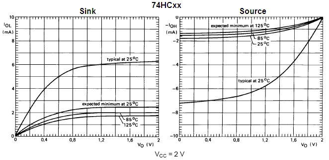

I found a Philips article that spec's the typical output source current from a 74HCxx device is a whopping 7mA when its supply is only 2V. An LED is very bright with 25mA.
The "powersaver" circuit uses a Schmitt-trigger oscillator to charge a 22uF capacitor to 2V then the output switches it in series with the 2V supply to drive LEDs that need more than 2V. Since the 74HC14 has a typical output current of 7mA and the duty-cycle of the oscillator is about 50% then the LED glows diimly with an average current of only 3.5mA.
2V is when a 3V battery is nearly dead. I would parallel 5 of the inverters in a 74HC14 to charge the 22uF capacitor and drive the LED with much more current to make it nice and bright. Then I would add a diode in series with a resistor to make the oscillator blink the LED on for a very short time to save power.

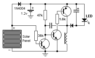

My solar garden lights use one 1.2V Ni-Cad cell and a voltage stepup circuit to drive the fading red, green and blue LED. One stopped and I reverse-engineered its circuit so I could find and replace its shorted diode.
