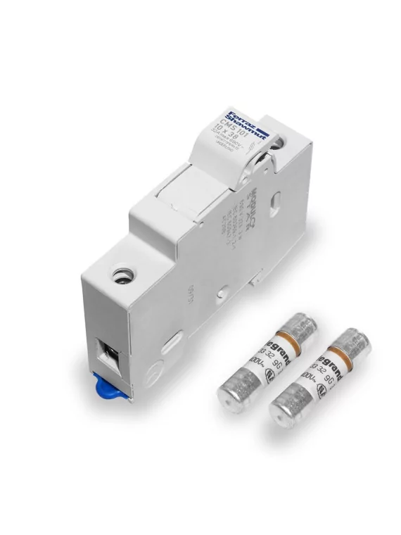

These should be suitable for the solar panels:
or
