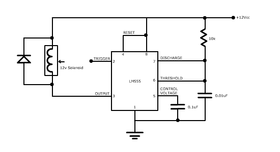

This is what i came up with.
Please see whether it will possiblely work out.

Going with your idea i place a diode parallel to the soldenoid.
Well, it didn't actually work...
yes there is a some sort of turn on and off for the soldenoid...
But it is rather unstable or some sort..
It only works like for 5sec and the stop moving... hiaz..
is there something i forget to connect or?
i also notice that the 555 timer begins to heat up after the soldenoid stop..
Help please...

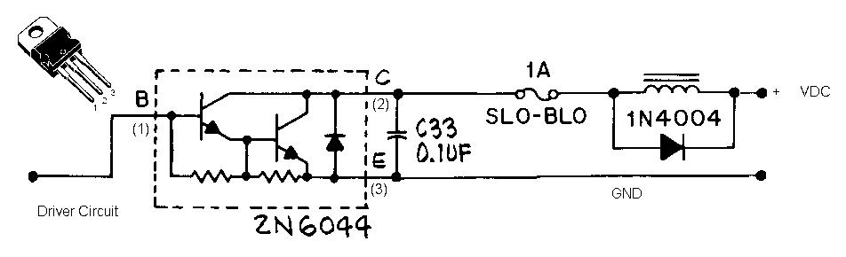

Nigel Goodwin,
power transistor??Err... do u have a part number?
how shld i connect it?
Thanks in advance..
Most small to avg. sized solenoids work well off of the TIP series Darlington transistors in the TO-220 style case. Heat sink the transistor. Many of the pinball solenoids were driven by a TIP120 Darlington. Below is a circuit that might work for you. It can operate from 12vDC - 30 vDC and the base or pin 1 is the trigger signal input.

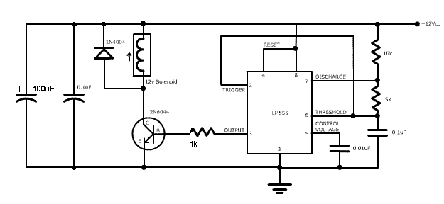

Ok with alll the information here i designed this circuit.
Can someone verify for me please?
Cause i wanted something that trigger automatically like a vibrator...
Therefore the previous configuration for the 555 timer is wrong.
I have now config it to Astable operation, to produce a "square wave".
Will this work? If not, can someone help me by drawing the correct circuit?
Really really urgent now.. Thanks in advance..

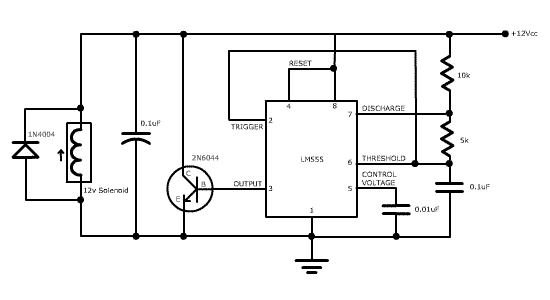

I've redrawn your schematic with the necessary corrections.
You currently have your frequency set at 720Hz. I don't think you'll get much vibration at that frequency - just a tone. The 555 datasheet has the equations for frequency and duty cycle.
one other point - the 555 can sink or source up to 200 mA on it's output pin so depending on the solenoid, it may work ok without a driver.
the package can dissipate quite a bit of power (relatively speaking for a DIL-8) as well. if you set the duty cycle reasonably low, you should be fine on the heat (as long as the current is within the limits).

Hi pple,
Thanks for the help.. the circuit is fine now..
Now just have to integrate it... Hopefully everything will be fine.
Will keep u all updated..
Wish me luck.
SO, did you end up using the circuit submitted by Ron H?
Yes i end up using the circuit by Ron H.
Cos without the power transistor.. the 555 timer get heated up easily..
Thanx Ron the circuit helped me alot...
