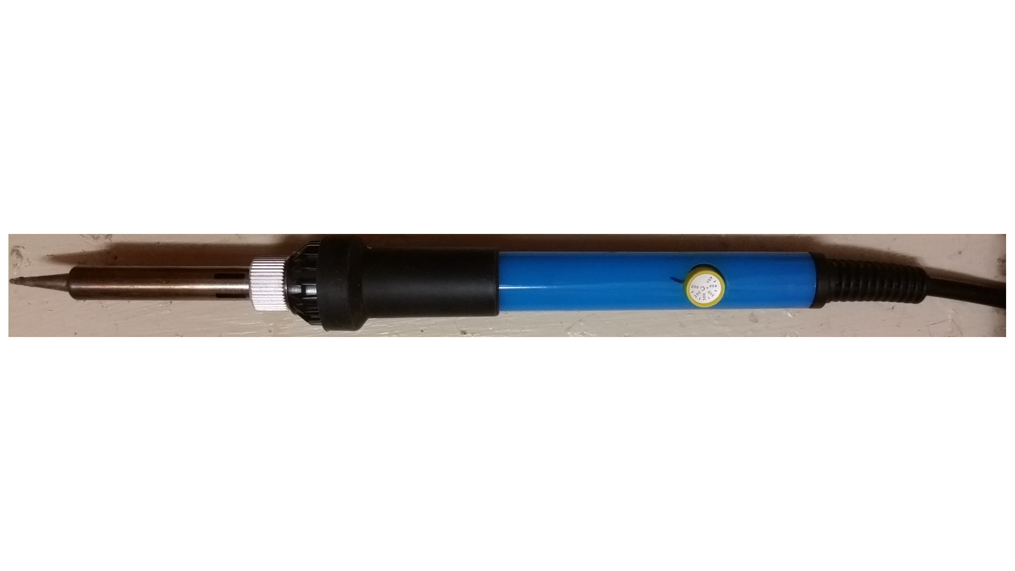

I was thinking of replacing the 18650s in my Dewalt battery when they go bad.
When using tab wire, what temp do I set my iron for?
The iron is a Hakko wanna be.
My iron goes up to 450C if I am reading the dial correctly. (It had no manual. :)
118141
I read that you should go hot and fast to avoid ruining the battery.
Are you using 18650 lithium battery cells that have solder tabs welded on each end? My soldering iron has a fixed temperature of 370 degrees C for all soldering that takes only one second. Maybe your soldering iron has a light dimmer circuit for variable power without controlled temperature.

AG is scaremongering as usual, Li-Ion batteries solder quite easily, clean them first with abrasive paper, and solder them as quickly as you can. We use leaded solder (lead-free solder is useless stuff!), with an iron set to 325 degrees C - I presume AG's is for lead-free, as it's rather hot for leaded.
