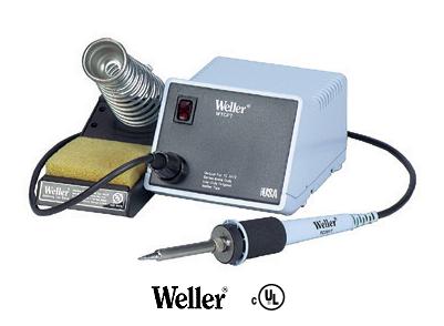

Mine looks similar to that in the image but being an older model the sponge and holder are an integral part of the case instead of two separate pieces as shown. The case contains a 24V transformer.

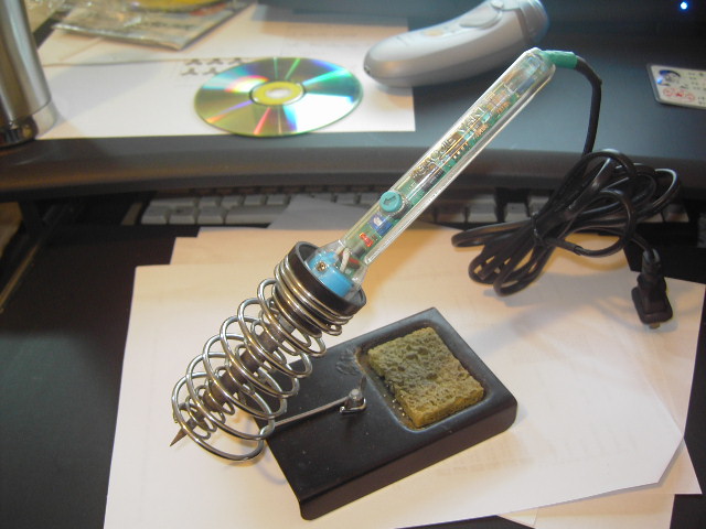

I've been using my 60W temperature adjustable iron.It's still young,only 3 years old(I bought it when I was a freshman).It has a variable resistor in the handle for temperature regulation.The standard power supply is 220V/50Hz,which gives a temp range of about 150C to 400C.It's a domestic brand,and cost me 72RMB(less than 9 USD).So far it's still the best iron in the store where electronic tools are sold.
I love to use it because there's usually a lot of surface mount components on my PCBs.However I don't like the way the wire is fed into its tail.I've tried to reinforce the wire terminal inside the tail but it was so tight that nothing could be attached there firmly.It feels like the wire is ganna break sooner or later.[/url]
