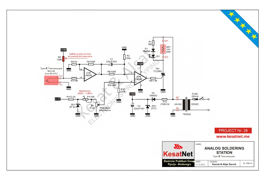

Hello,
I have a Gordak soldering iron and I want to build a circuit to control this soldering iron.
I chose the attached schematic.
Unfortunately, I did not found the needed triac at the store (TR1).
1. What substitute do you recommend for this triac ?
2. Does R5 protect the soldering iron from overheating if the thermocouple is accidentally disconnected ?

A TIC206 is a VERY, VERY common small plastic thyristor, if your store doesn't keep it then they probably don't keep any at all, order it on-line.
You are correct about R5, it turns the element OFF if the thermocouple goes O/C.
1. Assuming that I have a new schematic, can R8, R7 be safely replaced by 3k3 and R19 be safely replaced by 2k2 ?
2. What is the functionality of IC1B, in the attached schematic ?
  • schematic_correct.pdf
Yes.
No idea, it's output isn't going anywhere, the only thing I can imagine is that it's used as thermal feedback for the entire IC, bearing in mind they are all on the same chip of silicon. Or it's a rather silly method of getting rid of the unused fourth opamp? :D

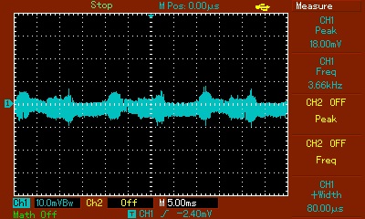

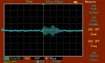

Hello,
I built the attached schematic and I wanted to find if the TL431 oscillates, using an oscilloscope.
I tested by connecting the ground probe to the 220uF capacitor ground and the detachable hook to TL431 catode.
The measurements were made when the soldering iron was connected into the circuit.
Can you please explain if there are oscillations in the screenshots ?

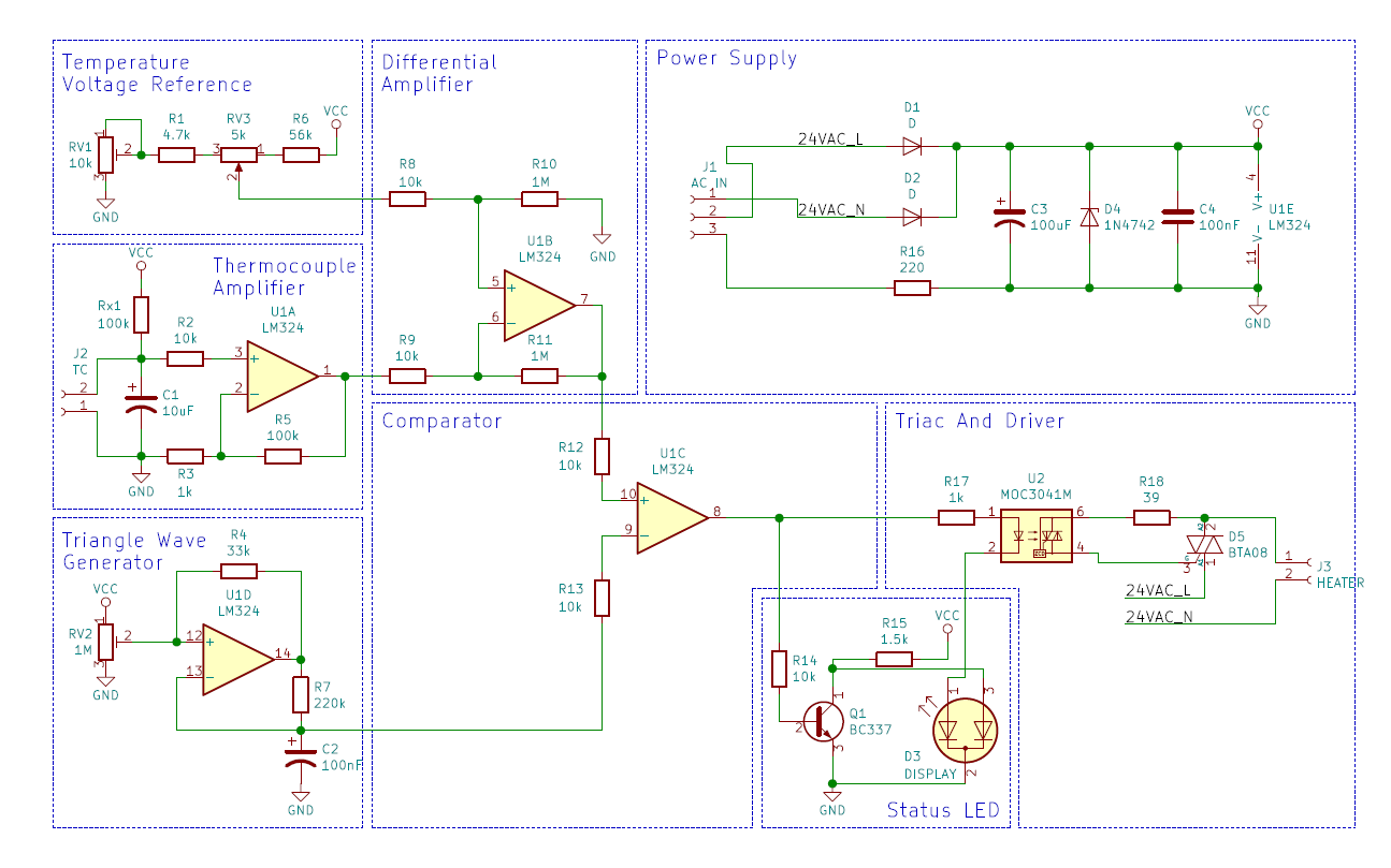

Hello, Does Rx1 (100k at the thermocouple amplifier block) protect the soldering iron from overheating if one or both thermocouple wires are disconnected ?
The project is from: http://electronics.vlzqz.com/home/lm324-analog-soldering-station
Also, I saw that using MOC3041 makes the LED flashing at a higher frequency in comparison to when using MOC3021. Which one, between MOC3041 and 3021 is recommended for this project ?
