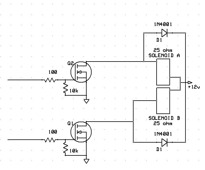

I took a stab using a little of what Ive learned about MOSFET's. This is a separate part of my transmission project. Would this circuit operate as Ive draw it? The Gate signals will come from a 4028 (not drawn). Ive attached a datasheet for the MOSFET I would like to use. What do you think?

looks OK to me.
The MosFets shouldn't even require cooling. although this can be done with a copper area around the drain pin.
