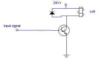

Ok Audioguru, This is my first schematic with MS Paint, so don't laugh.
This demonstrates what I was trying to explain to you ritayshida, in a schematic.

Hi HJ,
Nice schematic. Did you know that lines are straight when you hold down the shift Key?
Did you know that JPG files like yours show schematics with fuzz, but saved with GIF or PNG file type are perfect?
JPG is a lossy compression technique for photographs.
GIF and PNG also compress, but without loss for schematics. :lol:

1. The schematic I posted does just that.
2. if the old solenoid used an IC to amplify the DIO signals, then again the schematic I posted does the same thing.The Darlington transistor TIP 120, is very responsive to low power input signals, and can handle 5amps? at 12V. I can't remember exactly, but you can look that up to make sure.
All you would have to do, is calculate the resistor value for the input signal, and also check to see if you would need one in series for the solenoid.
Good Luck!

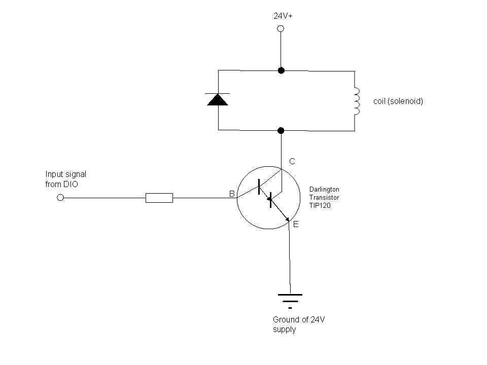

Thanks A LOT!! Especially hjl4, I appreciate that you put the effort for me to draw the schematic which really help my understanding. I want to try the circuit you described. I am literally Electronic Newbie so that I drew your schematic by myself just to make me understand what is drawn on that. Is mine right?
PS. I used the PowerPoint since I know they can draw connectors and also found the website (http://www.kpsec.freeuk.com/symbol.htm) which we can download the circuit symbols as gif format and so on.
Your schematic looks fine to me.
Glad I could help you ritayshida!
Good Luck with your project..
