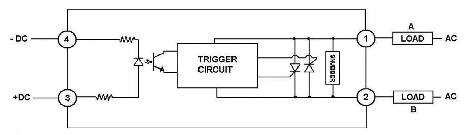

The attached is a simple image of a SSR circuit. Generally they don't care which side the load is on. Either A or B should work. This assumes that the Australian power is 240 VAC Line to Neutral as you explained.
You mention that your control voltage is 24 VDC and you also mention 1 mA. Most SSRs that use DC control use a control voltage between 3 ~ 32 volts. Could you provide a link to the part number / model number of the specific SSR you have? When you say 1 mA are you caying that your control voltage is limited to 1 mA? That sounds a little low for most generic SSR relays.
Something you could try if possible is to use maybe a 9 volt battery just to test the SSR and see if it turns the pump on. That would tell you if the problem is the control voltage inability to turn on the SSR.
All of this assumes a known good pump and I assume the pump is on a circuit breaker (GFIC) or fused in accordance with Australia electrical codes.
Just My Take
Ron

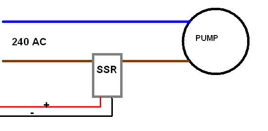

I do not know the actual power mains characteristins in Australia.
If you have one live 240 VAC line and a 0V neutral, use ONE SS relay on the LIVE wire and keep the 0V neutral intact.
If you have TWO 120 VAC lines that add-up for 240VAC, then use TWO SS relays, one per phase.
NEVER, i say, NEVER cut the ground wire !
You only need one SS switch in the brown (hot) wire. Usually SS switches don't care which one of the two terminals is used for load or AC line side.
If SS switch has hot labeled and load labeled it is only because it is preferred to avoid part of the triac gate driver circuitry being on the hot line when 'off' where it may be more subject to lightning surges that would be more inclined to damage triac driver. It will operate either way.
Other thought, are you sure you have D.C. to run SS switch control. Regular coil relays normally use 24 vac or line voltage AC to power relay coil. You can get SS switches that take 24 vac for control line if that is what the control voltage is.

Here's how I see it.
