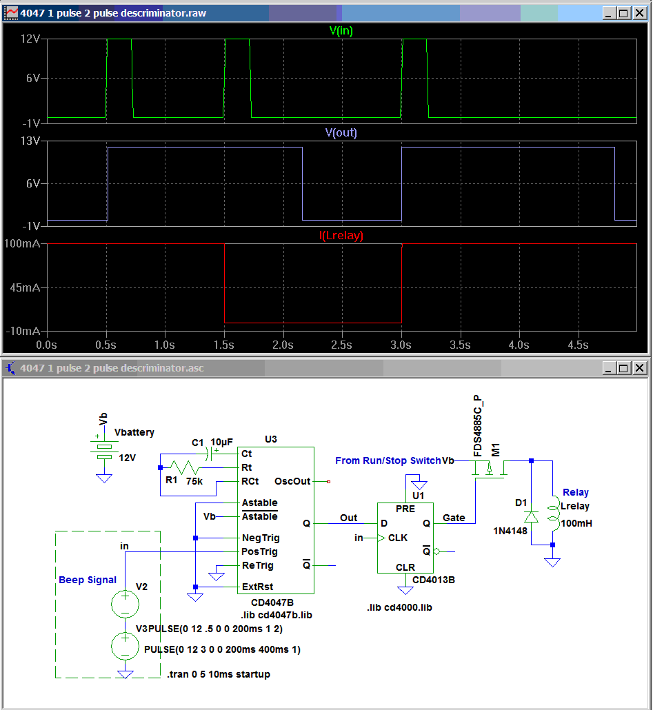

Hello,
It has been quite awhile since I have visited this forum. I have a situation where I need to toggle the current on a line by using the signals from the security module on my Harley-Davidson motorcycle. My security module is the early design that requires a push button FOB. My objective is to create a key less ignition switch. I have accomplish that but, there is a problem. What I did not count on was Delphi leaving the system relay unprotected when the security is armed. If someone was to toggle the run/stop switch to run then it activates the system relay which in turn starts the fuel pump and lights the instrument panel as if the bike is ready to run but, it won't due to the security disabling the ignition through the ECM. Delphi provided no usable output from the security module that could be used to control a relay. All that I have is two BEEPS when I arm the security and a single BEEP when I disarm the security.
When the security is armed then I need to break the connection to the system relay. I know that the current that creates the tones can be used to toggle the connection but, I don't know how to get there? Do you have any suggestions?

Thank you for sharing your crystal ball with me. ;) Yes your understanding is correct. I have easy access to that signal. I just recently added a PIEZO siren to the motorcycle and that is where the beeps are being generated. I have not timed the beeps but, I'm going to say a ½ to 1 second. I continue to get this image of three timer relays but, so far they are all laying on the bench in their package. I actually have a timer relay floating around in the US Postal Service. It was to be used to lengthen the notification signal from the security module. As is it sounds like a 50s VW horn. I want one complete shrill chirp so everyone will know that I just armed the security module. I would prefer to stay away from an electromagnetic relay if possible.
I have successfully created a key less ignition and only I can start the engine. The problem is that Delphi did not protect the system relay. If someone was to toggle the run/stop switch to run while the security system is armed then it will power up the fuel pump and all of the instrument panel lights come on along with all of the turn signals flashing. If I was away from the motorcycle for a few hours then I might return to find the battery drained.
Arm the security system: BEEP, BEEP. Disarm the security system: BEEP. Those tones are generated with 12 Volts. On the BEEP, BEEP I need to disable the circuit to the system relay and on the BEEP I need to enable the circuit to the system relay.

Below is the LTspice simulation of a circuit that should do what you want using a one-shot and one flip-flop.
The relay is denergized after receiving 2 beep pulses within the one-shot period, and is allowed to be energized from the Run/Stop switch after a 1 beep pulse.
On the first pulse, the one-shot output goes high, setting the FF D input high. If the one-shot is still high when the 2nd pulse arrives then it triggers the FF Q output to the high state, turning off the P-MOSFET (Vgs = 0V).
After the one-shot times out, the FF D input goes low. The next pulse then triggers the FF Q output low, turning on the P-MOSFET (Vgs = -12V) .
The transistor driving the relay can be just about any P-MOSFET with a 40V or higher rating.
Note that the power and ground pins for the ICs are not shown and must be connected.
The power draw of the circuit is negligible so it can be left powered all the time.
Connect all unused IC inputs (not outputs) to ground.
Not shown is a 100μF filter capacitor you should add from the +12V to ground.
Edit: I just noticed that capacitor C1 must be non-polarized so it needs to be two back-to-back 20μF electrolytic capacitors instead of one 10μF.

I'm reasonably confident that the pulse discriminator circuit I showed will work, but since it's only been simulated and not built, there's no guarantees. ;)
