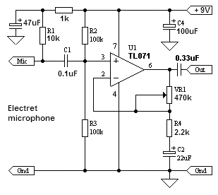

Here is a mic preamp that uses a low noise opamp. The 470k trimpot has a high value to make the max gain 215. If you don't want such a high gain then a 100k trimpot makes a max gain of 46.
The max output level is 3.3V when the 9V battery is new.

thank you for your help audioguru, but i was really hoping for something simpler, even if i'm making this as a gift for my girlfriend i just think i lack experience to make that circuit, since i'm having troubles with simpler lm386 circuit. is there any way to get somekind of lm386 preamp to work with lm3915? you mentioned that LEDs would be dimm with that circuit that has lm386 for a preamp and lm3916 for vu, but it seems that it works:YouTube - Microphone LED VU Meter.. so could i just replace lm3916 with lm3915? i already have all the components that it requres, only 3915 instead of 3916.. if that circuit doesn't work, i will do my best to make yours, since i really want to make this thing to work. if that doesn't work, i'll just buy another plug for computer speakers and connect that to vu..
You can use an LM386 as a noisy mic preamp if you want.
Here is the circuit:

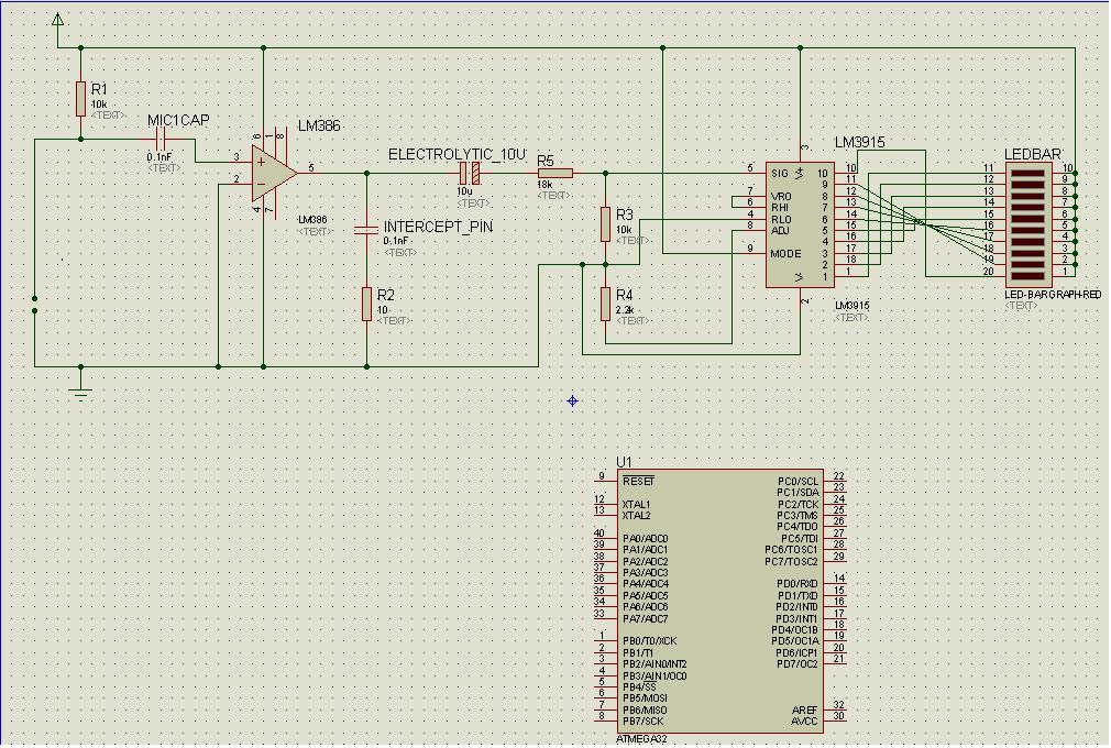

Hi I wanted to create an audio decibel meter using an lm386 with an lm3915.
I can connect a speaker to the output of the lm386 and hear the input at the output with a speaker. I need to know what i need to merge the two IC's so that they can work together. I have a decibel meter for calibration but at this point it is useless. I connected both grounds together as to make a common ground. Input to Pin 5 on the lm3915 is the output of the lm386 but I'm really not getting anything..Any ideas or help would be greatly appreciated..Thanks..
The LM3915 displays the AC or DC voltage.
But the output pin of an LM386 is a DC voltage that is half the supply voltage. Then the LM3915 will show a high voltage even if there is no signal.
Use a coupling capacitor to block DC but pass AC.
Use an low noise audio opamp as a preamp, not an LM386 little power amp that has hiss.
How do you interface an lm3915 with an Atmega32 microcontroller?
all I have to work with is port A on the atmega 32.. The microcontroller is set up to accept information already to portA.. The Led bar can be removed if necessary to interface to the atmega32. for the atmega a logic one is within 3 volts. zero is below.
Why are you using an LM386 power amplifier instead of an opamp?
The display will look like a dim blur if you do not use one of the peak detector circuits shown in the datasheet for the LM3915.
Your micro-controller does not have an input. What do you want it to do?
