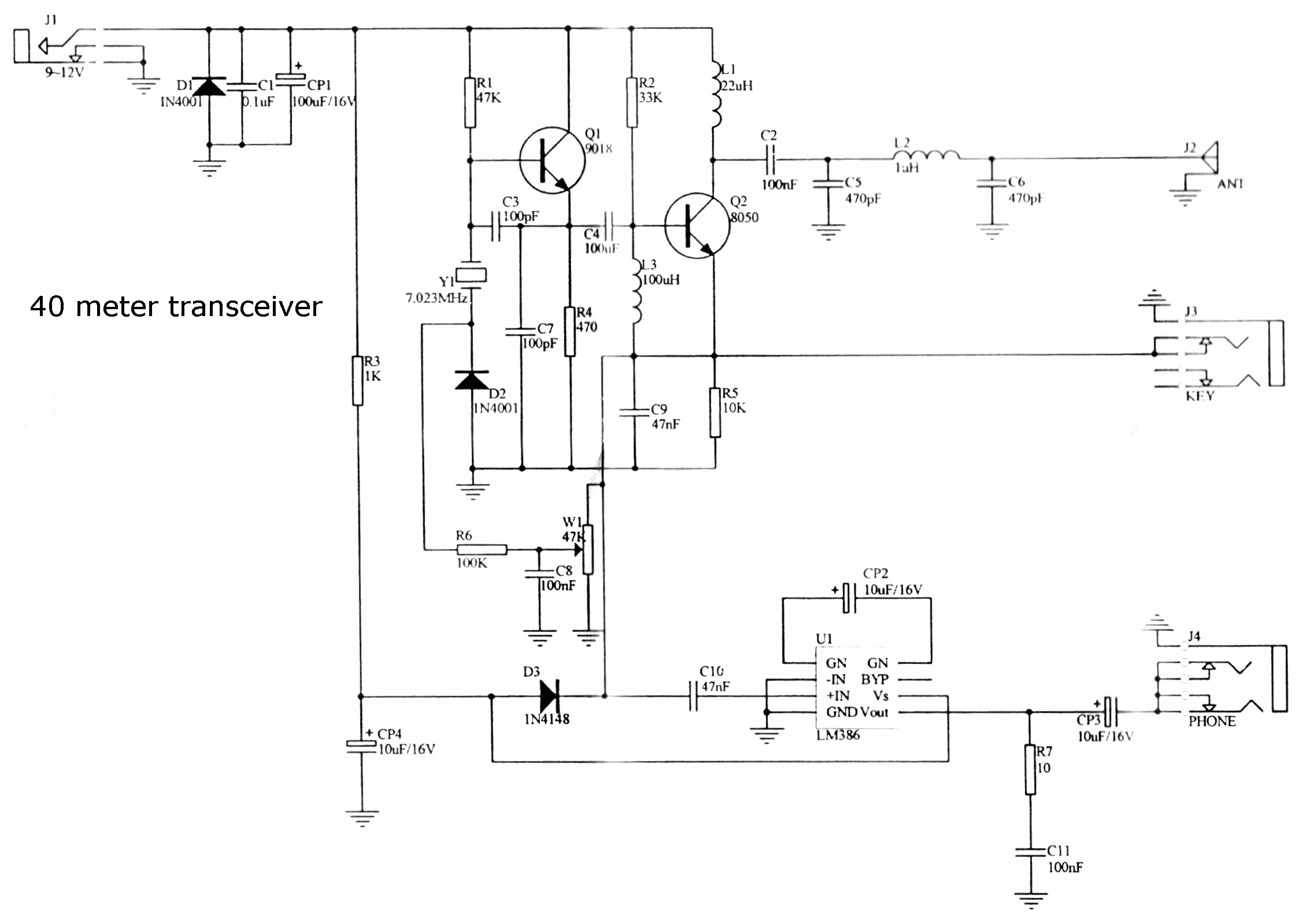

Transmitter is ok. Receiver sucks. Some type of regen. Lots of hiss but sensitivity is terrible. Adjustment pot does not seem to do anything or very little. Coupling a signal generator to the antenna gives just enough received signal to know that it is receiving. Almost nothing. No quieting.
I'm trying to understand the receiver. Having lots of trouble. For one, the antenna coupling is confusing me.
No point in me rambling further.
If someone would explain to me how this receiver works I'd really appreciate it. I don't think I'd find this circuit on-line and explained.
