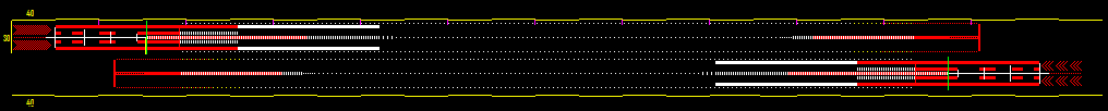

Just a quick diagram of how the runway actually look. I'm sorry if this is a bit small / unclear. One pixel = 1 LED, just to give an idea of the amount of LEDs we're talking about here. The yellow arround the edges are markings and do not form part of the circuitry.
The runway at the top is for approach from the left, and bottom is approach from the right. This will also give a good indication of the whole "reversal" of the entire runway....
The arrows at the approach ends will be forming a "chasing" effect, with the arrows moving from the approach to the runway. This is done with a 555 and L297 Stepper IC - at least that part works well already :)

I will seriously think of multiplexing LED's or banks to save on power.
