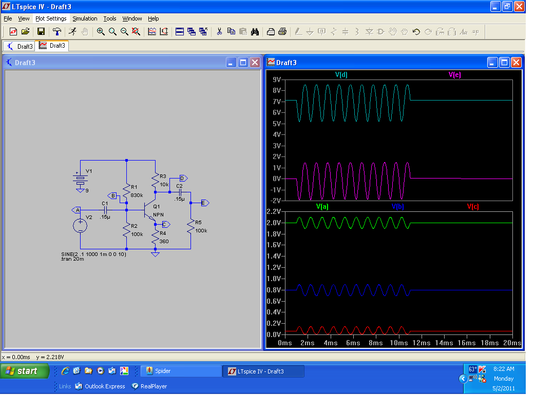

Ahh! Okay! So, the signal is doing this:
Then, however how much the base varies it will take more or less of the signal? Or have I missed it again?

Maybe a picture will help with the explanation. The circle is just the input like an IPOD or something.

Since the value of the emitter resistor is so small at 360 ohms then each transitor will work differently depending on its hFE.
The low value for the emitter resistor causes even the temperature of the circuit to affect how much distortion it creates.
Your signal path is not good. Capacitors pass AC (the signal), and not DC (the bias). The signal modulates the base in the form of a current.
A BIGGER current modulates the current flowing from the collector to emitter which causes an AC+DC componect at the collector. the capacitor isolates the DC component.
