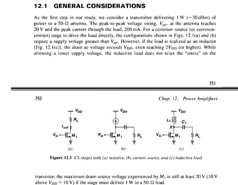

Hi, please help me with this section from my text book about power amplifier.
power-amplifier-1-modified-jpg.75114
power-amplifier-2-jpg.75115
power-amplifier-3-jpg.75116

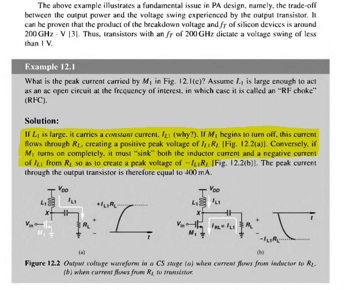

Q1: If L1 is large, it carries a constant current IL1 (why?)
My answer: I think Vin includes two components: DC bias and ac signal. Therefore, the current flows the inductor also includes two components DC bias current and ac signal current. Because the ac signal is blocked by inductor at high frequency therefore IL(ac) = 0. The only remained current is DC bias current and this current is constant.
Is that right?
Q2: If M1 is turn off then why IL1 still exist? I think it is a characteristic of inductor but not sure.
Q3: How long does the current exist?

Hello there,
This text has 'tricks' written all over it. That's because the way the MOSFET is being modulated is not shown. They do say that the output can be 2x the supply voltage, but if we apply that spec then we dont see any DC current in the inductor.
Normally we might see DC current in the inductor if the output is biased to 1/2 Vcc, but that's not the case if we assume that the output is 2x the supply voltage such as 2vpp with a 1v supply voltage. And that is because if we assume the output is a sine wave then the output is a sine wave and it is centered at 1v, the exact value of the supply voltage (with 2x output that is). So the inductor sees a plus and minus sine wave and that's it.
So you'd have to resort to asking the instructor or looking at the previous parts of the book to see if there were any kind of assumptions we might apply. I dont like doing an analysis for a very simply specified circuit with more complex questions.
For Q2, if your M1 is turned off at a point where L1 has zero current then there is no current left. If it is turned off any other time, the circuit defaults to an inductor with initial energy in series with a cap in series with the output resistor, so you'll see a damped sinusoid with maybe a couple humps, and that is because the inductor and output cap resonate for a cycle or so until all the energy is dissipated. This is a second order system.
For Q3, the current would last until the energy is dissipated, and that depends on where in the cycle the M1 was turned off.
What else bothers me is the circuit complexity does not seem to match the questions. The questions require more knowledge about what is going on and what kind of parts are used.

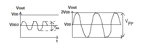

Sorry, I am not quite understand your point here. This is related to another question of mine here: https://www.electro-tech-online.com/threads/required-supply-voltage-for-common-source.135761/
I think you meant the voltage across the inductor in two cases:
inductor-v-jpg.75135
However, I don't see why in the first case if the output is biased to 1/2 VDD the DC current flowing though inductor is not zero but in the second case when output is biased to VDD the DC current of inductor is zero.
To me the average voltage across the inductor in the first and second cases are VDD/2 and VDD respectively and therefore the DC current through inductor are not zero in both cases.
Could you tell me where I am wrong?
Thanks, I understand it now but one point. According to Q1, IL1 is a constant, then how can the current flow though the capacitor?
From the Last line:
Current flows through the capacitor in a transitory way. It does not conductor forever, just for a relatively short period.
From the beginning:
Think about the inductor being connected between Vdd and 1/2 Vdd. If Vdd=2 volts then the inductor already has 1 volts DC across it. This leads to a DC current. But what is not specified is the internal resistance of the coil so we dont know what that DC current is.
But now think about if the inductor is connected between a DC source Vdd=1 and a sine source of Vs=sin(wt)+1 . The voltage across the inductor is:
VL=Vs-Vdd=sin(wt), which is a completely sinusoidal voltage so there's no DC current (in the ideal case).
Similarly, if the sine source is only 0.5*sin(wt)+1 then we have 0.5*sin(wt) across the inductor, still a sine source. The reason we assume this kind of source is because if the output is specified as 2vpp then it is a sine source and since it varies from 0v to 2v it must be centered at 1v, so it is a sine source offset by 1v DC. Similarly, if it varies from +0.5v to +1.5v then it still has an offset of 1v DC.
Thanks! This is the first time I have understood it.:D
I considered the inductor is ideal (with no internal resistance) and therefore I can't see DC current component.

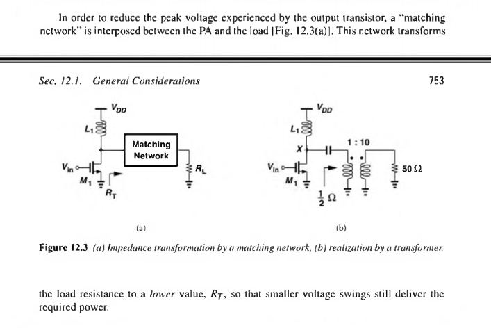

I want to ask another question about matching network in example 12.1.
My understanding is that it is used to reducing the peak voltage across load resistor RL. In this case the voltage across is a pulse with 2IL*RL (peak to peak).
Q: Why we need to reducing the pulse?
Real inductors and capacitors have lots of parasitics too when we get into RF circuits. This makes it difficult to understand what is going on sometimes.
