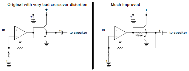

I installed Goldstar (now called LG Electronics) made in Korea telephone systems in 1980. The telephone speakers were driven with a pair of complementary emitter-followers with their bases tied together, something like the output of an LM324 or LM358. They were driven by a pretty good opamp with overall negative feedback. The crossover distortion caused many complaints. :cry:
I added a resistor from the output of the opamp to the speaker so that the opamp drove the speaker directly at low levels and the transistors began working for higher levels. Luckily, the speakers were 63 ohms so the opamp could drive them to about 0.7V pretty well.
When users heard the big improvement I couldn't modify them all fast enough. :lol:

The resitor idea has been around for a long time.. I believe it's called "current dumping" in audio literature. In the situation where the opamp cannot drive the load even at low levels (like say for a 4 Ohm or lower load), I've used constant current diodes there to drive as hard as it can while not short ckt current limiting the opamp. That alone is usually enough to make any distortion much improved.

On an LM324 or LM358 circuit, a load from the output to the negative supply bypasses the output PNP transistor, causing the output NPN darlington transistor to do all the work in class-A with no crossover distortion.
There is a 50uA current sink from the output to the negative supply. Therefore the output NPN transistor does all the work in class-A when the load is direct coupled and connected to the negative supply, or when the load is capacitively coupled to a very high resistance load. The 50uA sink must be increased by adding a resistor from the output to the negative supply so that the output NPN transistor can continue operating in class-A with a lower resistance load.
The crossover distortion is caused by an NPN darlington transistor pulling-up the output and a PNP transistor pulling down, with their bases tied together for low idle current. Therefore the output has about a 1.8Vp-p to 3.0Vp-p dead zone.
Negative feedback doesn't help reduce the crossover distortion very much because the IC has a narrow bandwidth and an open-loop gain of only about 60 at 10kHz. If your circuit has a gain of 200 like an LM386 power amp with its gain-boosting capacitor, then there isn't any negative feedback in an LM324 or LM358 above about only 2kHz. :lol:
