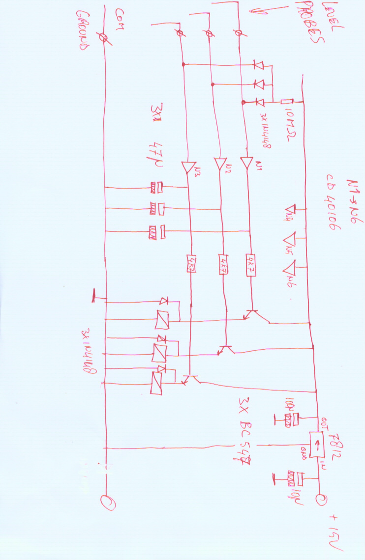

some sugestions to make it better please ??
rjvh
this is a design for a water level probe that i have now on my work bench and try to get some improved working
it was pretty sensitive (relais chattering) before i put the capasitors in but i am afraid that if i make the probe cables longer they still pick up noise and don't work properly
is shielded cable a solution??
or is there another solution?
please advice
Robert-Jan
hi Robert-Jan
A simple resistor/capacitor filter on the inputs from the rods, would remove most low levels noise
anny sugestions about the value
the resistance of the water between the propes is measured over the farest probe litle under the 2 M ohm would that be suficient if i would put a normal capacitor on 10 n between the probe and comon probe???
Robert-Jan

Use good quality low leakage capacitors, so as not to load the 10M0.
Is that 40106 OK.? with the 47uFs directly on the output pins.
I would also follow Mike's suggestion regarding the relays in collector.
the relais are already changed from position the capacitors is wat i have laying around and localy bought (that means ???? for the quality thing)
will experiment a bit more
Thanks for the sugestions
Robert-Jan

Quality, I mean capacitors that have a low leakage current.
probably i have the good one than because the circuit is working perfecly now
put between the probes end the comon probe 47 n Farat
did change the location of the relais and i could remove the 47 uF it works as good without as with them
jump now to another part of my project
Robert-Jan

Another problem area, is mains 'hum' pick up on the high impedance CMOS inputs which are tied to +V via a 10M0.
The inputs need 1M series resistors to help prevent destruction of the IC from static electricity.

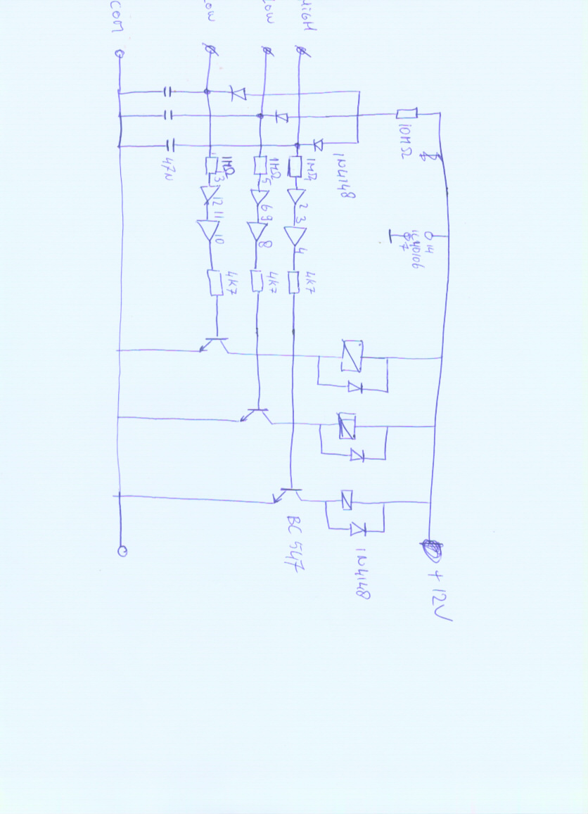

Thanks for all the sugestions
as shown in the shematic this is as i have build it now and it seems to work fine on my work bench
put the extra inverters in to the circuit to get a better efficiency as the purpose is that the Water tank should be full so that means the relais are now in the new schematic only activated when the level drops
for a sump it would be other way around
still another question
about the hum in the suply (as eric mentioned)
the suply comes from the 7812 and accompanied with the usual capacitors
is it still advisable to use shielded cable??
its my intention to put the the whole circuitry as close to the probes as posible (3 meters Max) and that only the relais switch contacs will be wired to the main control panel so that is already a different circuit
Robert-Jan
hi Robert-Jan
I would recommend adding decoupling capacitors on the supply rails.
Also increase the base current into the relay transistors.
Added the 40106 inversion 'circles'

Eric thanks again for your advise, consider it done
the decoupling capacitor (100nF) i always put next to any Cmos IC but often forget to draw it in a schematic during the "designing phase" and put it in the drawing when everything is finished
Robert-Jan
