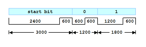

Very nice Jason (AtomSoft), and all in a single file too (grin)...
So it seems Sony SIRC is something like this with base timing in intervals of 550 to 600 usecs?
sony-sirc-png.29754
A couple more questions about SIRC, please?
(1) Is the signal from the TSOP1138 type decoders "active low" when it's receiving the IR signal (signals reversed from my drawing above)?
(2) Do those signal times vary considerably?
Yes, it's active low.
Yes they do, which is why you can't reliably just send RS232 serial data over the link.
So my tutorial doesn't check for specific pulse widths, but if it's within a certain range or not, here's the actual code, the values are simply scaled to fit within a single byte, and have no precise meaning.

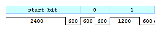

Im not 100% sure on my Receiver Part But I checked it with the PICKIT 2 Logic software and it seems to be active low. And inactive high. It maybe just my part now sure. I dont even have info on it. Ill try other receiver peice i have here and see if i get same results ok.
EDIT:
HEH i guess Nigel cleared that up :D
Thanks guys. Good info'.
Is it important to measure the actual active-low portion of the signal or could you simply measure the time between active-low leading edges?
sony-sirc-png.29779
Is it important to measure the actual active-low portion of the signal or could you simply measure the time from active-low leading edge to active-low leading edge?
It's important to measure the actual active-low time of each pulse, bear in mind it's not just a question of reading SIRC's, it's a question of rejecting all other types of IR signal.
