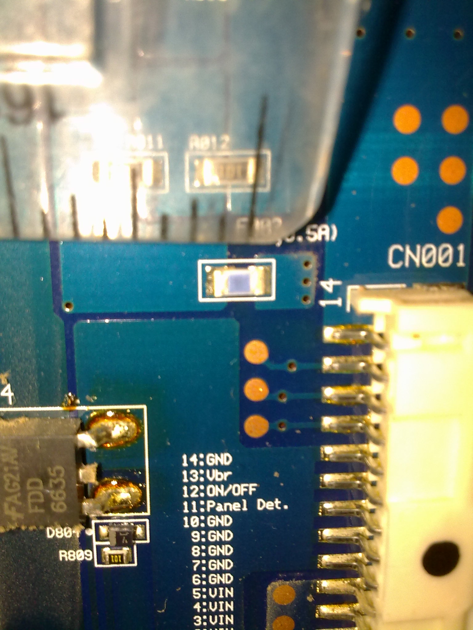

As a follow up, I've dismantled the television and it appears that F003 (500ma/63v) has blown. It also seems a fairly common problem with these televisions so I'll order up a new one and keep my fingers crossed.
It's on the inverter board to the left of the television. As you look at the connector towards the top right of the board, you can see F003 to the left of the large electrolytic.
The one on my board is open circuit and a few other forums have reported that replacing this with a fresh fuse cures the problem. I'm a little skeptical as fuses normally blow for some reason but it's worth a punt.

Stick a bit of wire across it and see if the set works - THEN (assuming it does) obtain and fit a new fuse.
Occasional failure of those kinds of fuses for no reason is quite common.

Just out of curiosity Nigel - would you use a T or F type fuse as a replacement ? I've got both on order but as the service manual doesn't include this board, I can't work out if I should go fast or slow blow.

The inverter is part of the LCD panel, so no circuit or spares available - but we don't stock anything other than anti-surge (T) fuses.
Hmm the inverter looked removable to me - I didn't prod it too much though but it appeared to have the tube connectors on the left and the power/control connector on the right and a few screws holding it onto the frame. I'll have a better look at it when the fuse turns up.
Hmm the inverter looked removable to me .
I didn't say it wasn't 'removable' :D
But it comes as part of the LCD panel, from the panel manufacturer - so Sony wouldn't even have a circuit for it themselves.
However, they have made the inverters available individually for a number of different LCD panels - though I suspect they are removed from faulty returned LCD panels.

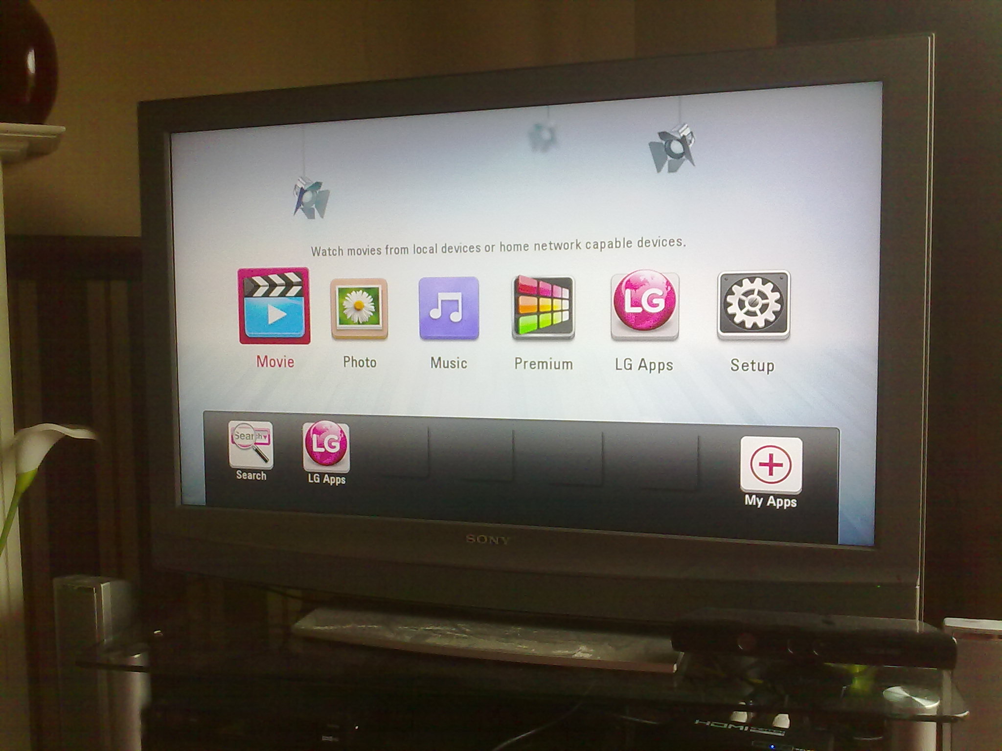

Well I've had 30 minutes out of it so far and all is good. There is obvious wear to the CCFL - they take a little while to warm up in certain places but it seems to be up and runnning :D
