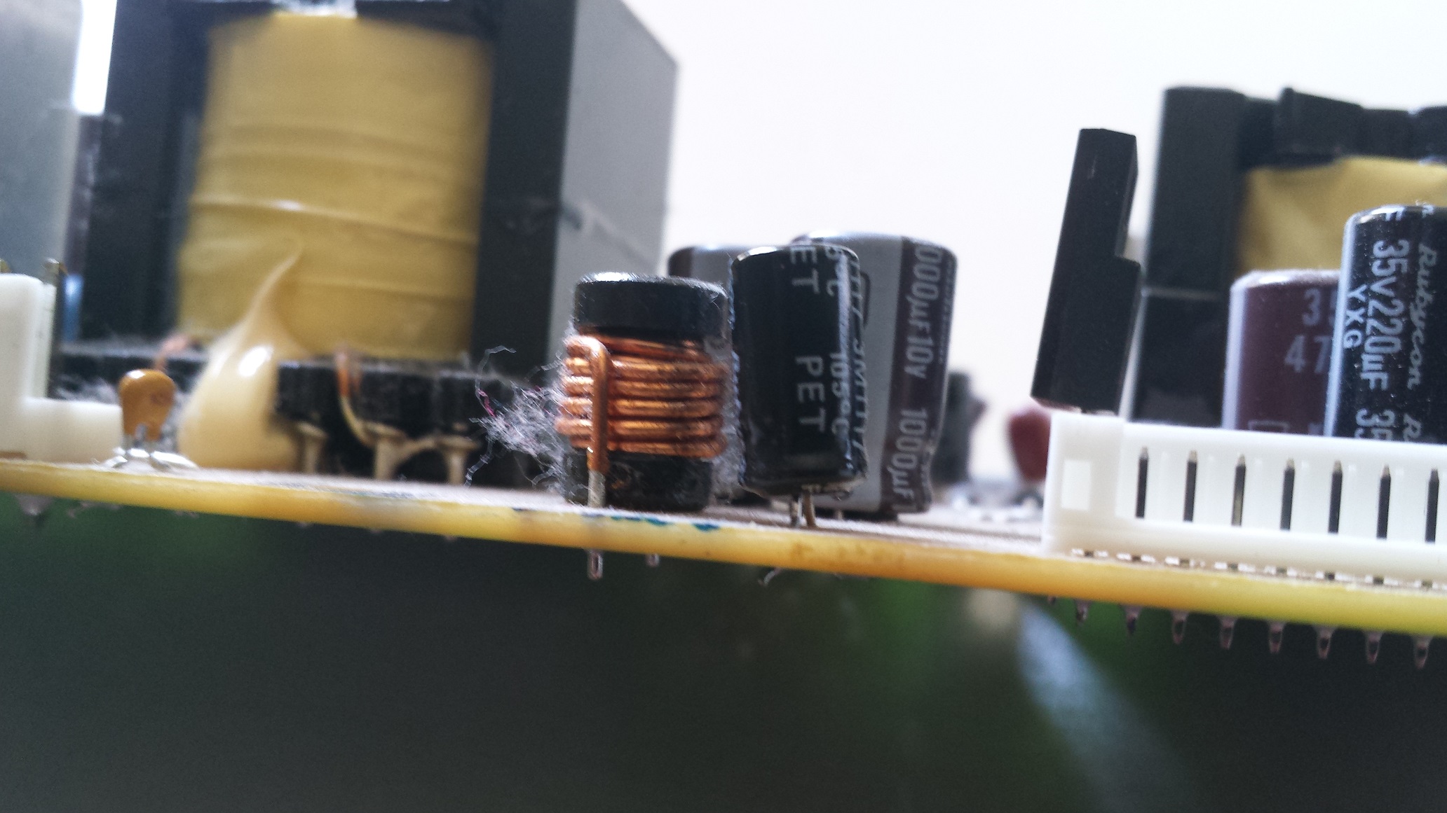

An electrical surge swept through my home as of recent, damaging most of my electronics despite their respective surge protectors. My surround sound system receiver (Sony HBD-E280) will not power on. I have a few questions for the repair community.
I have examined the board for visible damage similar to the burn marks on my other electronic devices' main boards but no success. I do have an image of what seems to be a burn mark on the coil affixed to the power module of the system but honestly I am not sure what to make of it.
Also, would it be incorrect to surmise the replacement of the power module would restore the ability to power on my device despite any other issues that could be present?

I don't see anything actually burnt in that photo, however, is that a piece of lint/ fluff on the board around the little inductor?, or is that from a capacitor that has burst? Either way, I think you are looking at primary switching supply damage. You will need to check various components with a decent multimeter to determine obvious problems like a shorted chopper FET, open resistors etc, or for low start-up volts etc. If you are not comfortable working with high voltages, take the equipment to a reputable service outlet and let them repair it for you. It is very easy to create further damage by accident, making any repair much more expensive. I would think that you should have a claim against the power company for all the damage, or was this a lightning strike?

Yes it was a bit of fuzz, and I'll make sure to check those components first. Actually come to think of it, there was a lightning strike incredibly close to the house hitting my back yard, which would definitely explain how it made minced meat out of the surge protectors. However, Ive never seen anything like this much damage. All tvs and cable receivers in my house have received hdmi damage and have had to be replaced, even my computer's onboard ethernet port as well as my cable router's ethernet ports have been fried.
