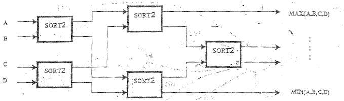

I'm trying to prove that it's you cannot use less than 5 Min/Max components in order to sort 4 input values.
Anyone has an idea how to?

Can't you sort A&D and B&C and then sort the two highs and two lows?
Edit, it doesn't work so forget this.
EngIntoHW,
It takes 1 level of sort to exchange the inputs by one position, such as from A to B. It takes 3 levels of sort to exchange the inputs 3 positions, such as from A to D. Each level except the last needs 2 units because of the 4 inputs. The last needs only one unit because only 2 inputs need to be sorted. That totals 5 units minimum.
