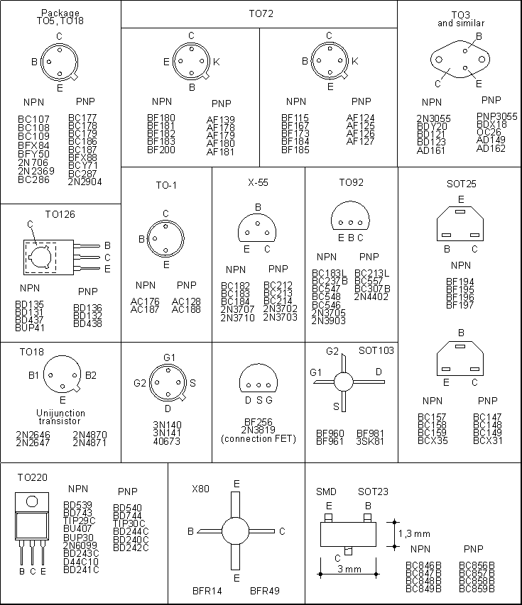

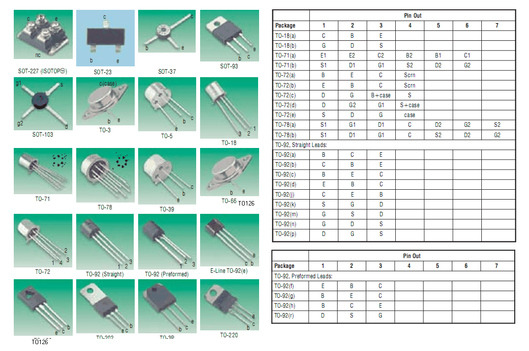

Are these any help.?
Thanks for the info. Some great "decoders" there. So, I'm assuming there is a standard pinout for a sot-23 package? I didn't see pin numbers in the sheets above.

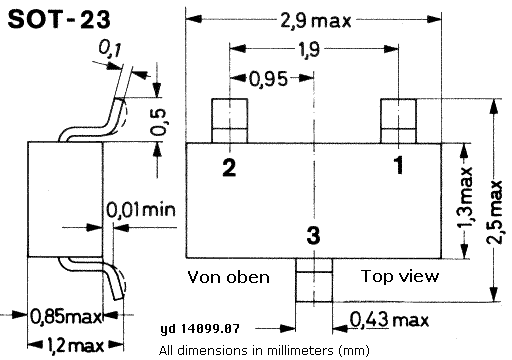

Mike,
If you open the datasheets that you linked to, you will find that on the very first page, a picture of the sot-23 package with the pins marked on it.
