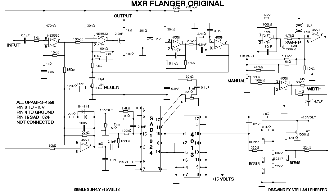

Im looking for circuit diagrams on a "Flanging" type circuit (Special effects) for sound...
I have managed to find this circuit. Has anyone done anything like this before? Any other suggestions?
