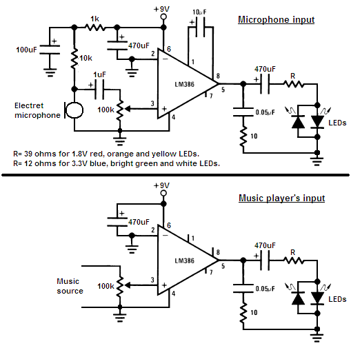

Here is my circuit. It uses an audio power amplifier to drive the LEDs with no damage to anything:

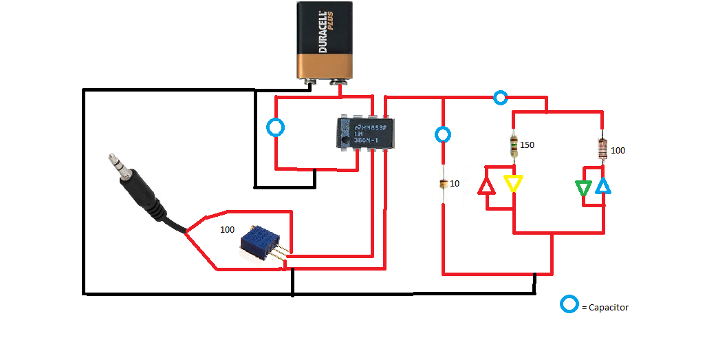

audioguru, thanks for the help, I'm not too sure i understand the LED portion of this schematic, is it possible to connect 4 leds(green,blue,yellow,red) or would that require substantial modification of the circuit? Due to simplicity and my lack of experience is there anyway to modify the schematic i pmed you to make it "safer" for my devices?
would it be possible to connect the 4 leds and a resistor to this? and also power the device with a 12v battery?
The Instructables schematic is garbage!
My circuit can safely drive many pairs of LEDs that have similar voltages. Connect your red and yellow LEDs back-to-back reversed in parallel with a series resistor and connect your green and blue LEDs back-to-back reversed in parallel with a series resistor. Use Ohms Law to simply calculate the resistors.
With a 12V supply the output of the LM386 swings about 5V peak so the resistor values are (5V - 2V)/20mA= 150 ohms for the red and yellow LED pair and is (5V - 3V)/20mA= 100 ohms for the green and blue LED pair.
The LM386 power amplifier can drive up to 10 pairs of ordinary little 20mA LEDs.
