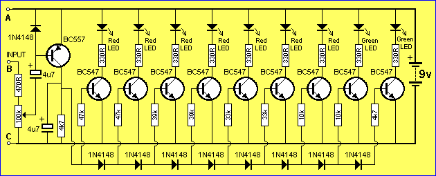

Hi Guys,
This do-it-yourself discrete "LM3914" circuit should be able to drive any kind of LED. It must have a terrific threshold voltage problem where input signals below about 0.6V peak will not light any LED, and voltages a little higher will light all LEDs.
The 330 ohm current-limiting resistors were probably chosen for old-fashioned 1.7V red LEDs to provide them with 22mA, but can still provide modern white, green or blue 3.5V LEDs with 16mA. Maybe he wants to burn the LEDs and his eyes with 50mA or more.
I bet the circuit is powered by a worn-out 9V battery whose voltage sags when all 9 LEDs light up. A 9VDC/500mA wall-wart power supply should make those 4000mcd LEDs blinding.

I forgot,
He is using low gain power transistors instead of the small very high gain transistors that are specified. That will make a big difference in brightness.

Hi Ms,
First you were using TIP31 and TIP32 low gain power transistors that are rated at 3A.
Now you are using an RF transistor (2N3563) that I couldn't find a datasheet for, that probably also has a low current gain.
Transistors with a high current gain are required for this circuit because most of the base resistors have a high value. The value is high for the base resistors because they are all in parallel and lower values would overload the PNP transistor.
The original circuit fed the LEDs about 22mA. Any small but high gain transistor will work well at that low current. They certainly won't blow-up. But the current gain of a power transistor will be very low, they are designed to feed Amps of current.
Since you measure a current (with all LEDs lighted?) of 150mA, each of the 8 LEDs is drawing 19mA, which is very close to their 20mA rating for 4000mcd. They should be very bright. Why not?
If your transistors had a high gain, the LED current would be about 88mA through your very-low-value current-limiting resistors and cause the LEDs and your eyes to burn-out.

Hi MS,
You contradict yourself. The LED can't light brightly with both loud sound and whispering sound, unless the circuit has a lot of gain and is driven to clipping with any input at and above a whispering sound. But then it would be bright with all sounds.
Your radio doesn't need to supply any power to this high input impedance circuit (except the supply power for the LED), the audio just needs to supply enough voltage (0.6V peak) to turn-on the PNP transistor as I explained before. If you used an opamp as an input preamp/recifier instead of the PNP transistor, there wouldn't be that threshold problem and you could easily make it as sensitive as you want.
How do you feed 150mA through a single LED without burning it out?
How do you feed 150mA through 60 ohms in series with a 3.5V or more LED with your supply of only 9V?
