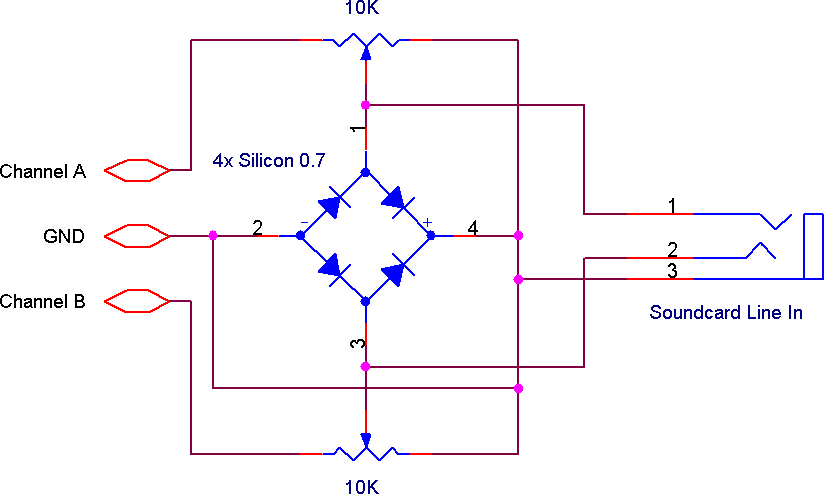

Something I came across, thought it might be a cheap & cheerful way to see waveforms on low frequency projects <20,000Hz. I'm testing it now and if it works I'll use it as part of my Lab tutorial for the Firefly kit I sell. Attached is a schematic for a simple adjustable voltage limiter for your soundcard.

Mind you sound card oscopes are without hardware modifications only AC coupled and usually have filtering stages in between. Another thing to think about is modern PC's have sound cards built in and there is usually a LOT of nasty noise on the various line and wave in/outs that can further distort readings. You'd be amazed at the crosstalk an audio processor will pick up when closely coupled with a PCI/USB or high speed processor interconnects.
It's not meant as a serious instrument, but mostly to see pwm width, digital signals (square waves) and the price is right. Most soundcards are A/C coupled so DC is out of the question.

Well the freeware scope software works...
1. the signal is inverted.
2. the A/C coupling rounds the squarewaves
on the plus side the frequency measurement was spot on, and the signal was quite useable for what it was.
