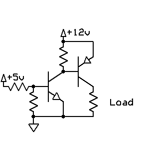

1. Somewhere on this site I saw a schematic for performing level conversion. It basically was an NPN driving a PNP and allowed, for instance, a 5v system to drive a 12v load. Can anyone locate that post?
2. Is there a chip which has an array of these "NPN / PNP" drivers on them (like a ULN2003)? I have found chips called "8 channel source drivers" (e.g. UDN2580), but I'm not sure they will do the same thing. In particular, the "source drivers" have a common source, whereas the "NPN/ PNP" drivers have a common ground.

Here is a schematic of a level shifter schematic. When the +5V signal is applied to the input the load will have about 12 volts applied to it. There will be a voltage drop across the emitter collector junctions.

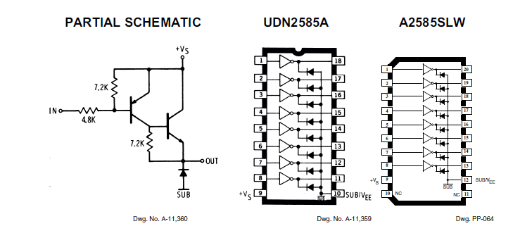

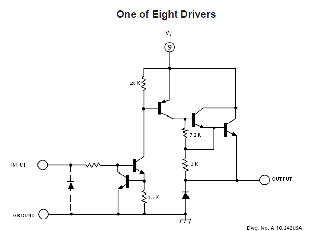

Ok, I think I figured out what was confusing me...
I've attached schematics of the UDN2585 and UDN2981 as taken from their datasheets.
The UDN2981 has an input NPN which switches the high-side PNP and it looks like it will work for me.
The UDN2585 does not seem to have the input NPN.
Note: the second image is the UDN2981.
