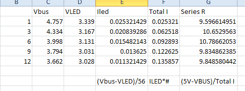

With the phone charger power supply (nominal 5V):
12 LEDs: 3.662V (per LED 3.028V)
9 LEDs: 3.794V (per LED 3.031V)
6 LEDs: 3.998V (per LED 3.131V)
3 LEDs: 4.334V (per LED 3.167V)
1 LED: 4.757V (per LED 3.339V)
No load: 5.081V

Not that it matters, but looks like there was a 10 ohm in series.
