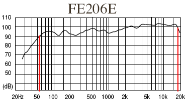

I find this interesting. It is the reccomended design for a Fostex driver:
https://www.fostexinternational.com/docs/speaker_comp/pdf/recom_enclose/206e_enclrev.pdf
It seems quite an elaborate design, but looking at the frequency response graph it doesn't seem very flat at all, or have very low extension? How would something like that sound; how much "wobble"needs to be in the response graph so it becomes noticeable/distracting? I'd like to see a response for my own speakers since I know how they sound, but have never found one.
Looks pretty horrible!, it's a very crude representation of a horn! - obviously to make it simple to build, but this will comprimise performance considerably. Most folded horns are a comprimise, but that's probably the poorest I've seen.
I wouldn't get too carried away chasing horn designs, far simpler bass reflex designs can give pretty impressive performance, and efficiency isn't too much of a worry with high powered drivers and cheap amps.
I think the frequency response of the fairly cheap, low power, 8" (20cm) FE206E speaker with wizzer cone is pretty good. The curve is valid only on-axis since the wizzer cone beams the high frequencies straight forward. Sharp peaks or dips in the response might have been smoothed out.
If the treble tone control is turned down slightly, its frequency response is plus and minus only 4dB from 52Hz to 17kHz. Very good speakers deviate 3dB.

Yeah, it covers the range quite well for a single driver, just doesn't seem awfully flat about doing it.
