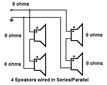

See the attached picture for connecting multiple speakers for a load resistance of 8Ω in effective assuming each one has 8Ω impedance.
In series connection, total resistance = R1+R2 where R1 and R2 are speaker resistance.
In parallel connection, total resistance = R1*R2/(R1+R2)
Suppose you are using a 2*20W stereo amplifier for this purpose for 8Ω load.
Each channel can hold 4 speakers of 8Ω in this way, so a total of 8 speakers you can connect.
For 30 speakers you need 4 stereo amps in this way. This is just an example you can connect more than 8 speakers if you have a higher power amplifier as the power will be equally distributed to each speakers. Got it?

What will happen if the speaker is simply disconnected with out connecting to another load resistance?
That you can understand by looking on to the picture I have attached. Disconnecting one from a series connected speakers will disconnect the others also.
The amplifier will have certain load impedance. Simply disconnecting will affect the effective load. Adding resistance in place of that is not a good method because a speaker is not actually a resistance, but an inductive load.
If you really want a switch for each speaker, there's no other way I think unless otherwise you have separate channel for each speaker!
