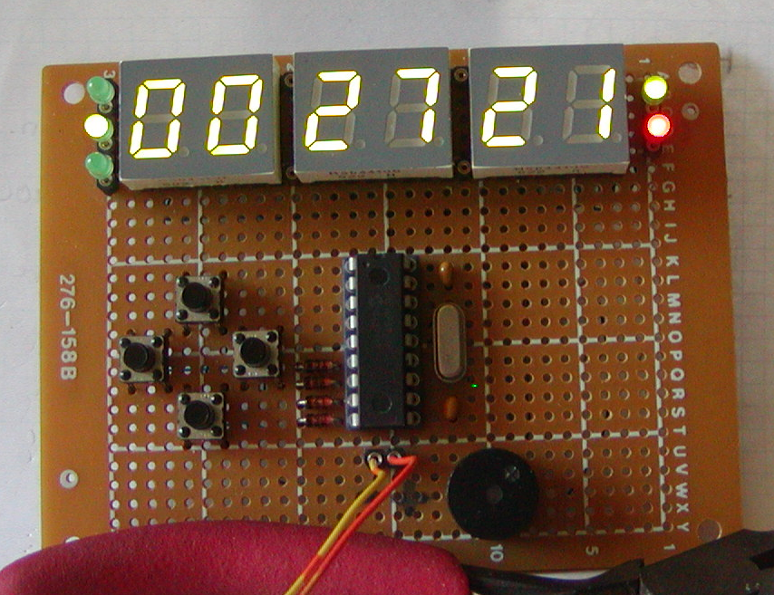

They used to make such things. I built my first 6-digit 7-segment clock in the late 70's using one of these ICs. You just added 6 transistors, 7 resistors, 6 displays, switches, a 1-Hz crystal time-base (which was a seperate little circuit board with crystal and 8-pin osc/divider IC), a speaker for the alarm, a regulated power supply, and a relay for the timer output. I wish I could remember the IC manufacturer and part number. Sorry.

Do a search for NTE2061. I'm not sure where you are but they cost about £6.50GBP :)

Internal oscillator isn't accurate enough for a clock, but for a mains powered one you could use the incoming mains 50/60Hz - which normally gives very good accuracy.
That's what a NTE2061 uses incoming mains 50/60Hz
Capable of 50Hz or 60Hz Reference Frequency
I think it's amazing and amuzing that I built almost the same Clock/Calendar/Alarm/Timer using a little PIC as the one I built 30 years ago with that specialized discrete IC (lol)...
Mike

Mke! you are making me jealous, your work always look so clean and right lol
That is a nice IC. Saves alot of time but only drawback is ... cant be upgraded.
In my new clock (gave myself a deadline of sept 2009 will include the ability to have a calender and multiple alarms for any day.
Jason (AtomSoft),
That picture in my previous post is of the novelty PIC charlieplexed clock (featured in the Projects sub-Forum; K8LH Novelty Single Chip Clock) so it's reasonably upgradable.
clock-2v1-small-jpg.21525
You're correct that the specialized IC could not be upgraded but it had a ton of features (6 digits, clock, calendar, alarm, appliance timer, etc.). It was an extremely expensive project too as I recall. The IC and the 7-segment displays were rather expensive. Then I had to buy the little 1-Hertz oscillator/divider circuit board and kit. Switches, Case, etc., added up to about $50 or so...
Regards, Mike
