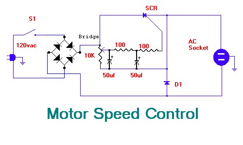

I found this circuit.
Ya that's called a chopper circuit, not good for exact control or the lifetime of the motor , but it will work.
If you put a NP 30-100uf @330 Vac cap across the AC socket, the motor woulnt get as angry( hot)as the inductive properties of the moters windings and the cap become a smoothing filter.
