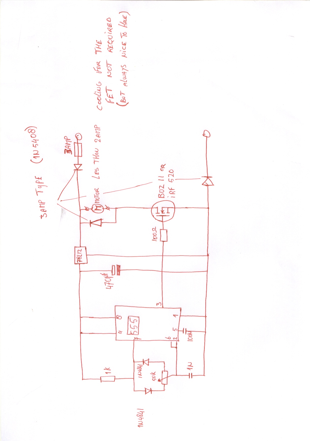

Hi I need help again please I have 24v / 100 va supply coming from a transformer to power a small motor. I need to be able to vary the speed from full power to 0 I know I will need a potentiometer but I am unsure of the size to use or if any thing else needs to be used as well as this.

i would make a PWM control to control the speed
can be simple made with a 555 a few other components and a FET as driver

I will post a schematic but that's a little later this day (have to work also and it's a busy day for me today)
Robert-Jan
here the schematic like prommissed
if anybody have sugestions to improve it feel free
the assumption is that you feed it with a AC voltage if you have already DC voltage you can skip the 2 diodes in the power line
the advantige of of a PWM is that you use less energy on lower speeds
and you have a beter torque (stronger and more resposive) on lower rpm
if you use only a potentiometer (like you sugested in your first mail) you will burn a lot of energy in the potentiometer which required a big wattage potentiometer (= expensive and hard to get)
good luck
Robert-Jan

i'm looking for a pwm, could a use a ssp60n06 mosfet (the same as phillips BUK456-60A). the mosfet is 60amp.

I am not familiar with that mosfet and it's one I can't buy overhere
keep in mind that they sell the mosfets amperage as it is measured by a single puls at a certain frequency and certain duty cycle at a certain D/S voltage
in real life they handle a lot less because its a repetitive puls with a variable duty cycle and higher voltages where you working with :(
also the cooling factor is importand (have a look into this mater verry intresting) ;)
the easyst thing to do in order to handle more amps is to put 1 or 2 parralel
don't do to many (your driver will not be able to steer them anny more deu to an increasing gate capacitance)

I checked the datasheet of the ssp60n06. Rds(on) is only 18 milliohms. Even with 4 amps, it would dissipate less than 300mW when on all the time.
