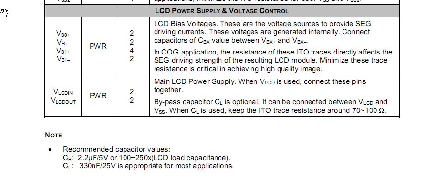

Yes, I have tried to read it, but it does not seem different (timing wise) from the initialization example in the datasheet of the display. All commands are just transmitted to the display using the standard SPI module in the PIC. Thus, the timing of the SCK and SDO signals must be in order. Now I can see the datasheet shows non-polarized capacitors, but I used electrolyte capacitors - will that change anything? If mounted correctly there should be no problem, right?
It dosn't specify non polarised caps.?
Do you have any non polar caps to try.
Is the LCD showing any pixel blocks.? after you try to initialise it.??
Also have you initialised the Contrast .?

Ia have initialized the contrast with the "Set contrast" SPI command, so I figured that would be on a default level. Also I see no pixels blocks at all, but I know the display is not defect. The non-polarized caps did not make a change at all. I think it is strange, since the hardware only requires simple VDD or VSS connections along with the SPI output from the PIC

I have looked thru the documentation for the LCD.

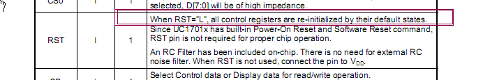

How do you have the CD[A0] and /CS0 pins connected.?
Also the Reset pin.?
CD = LOW (command)
/CS0 = LOW (chip always selected)
RST = HIGH (no necessity of resetting the lcd module during operation)
Its normal to apply the system /reset pulse at power up.? as the d/s states
