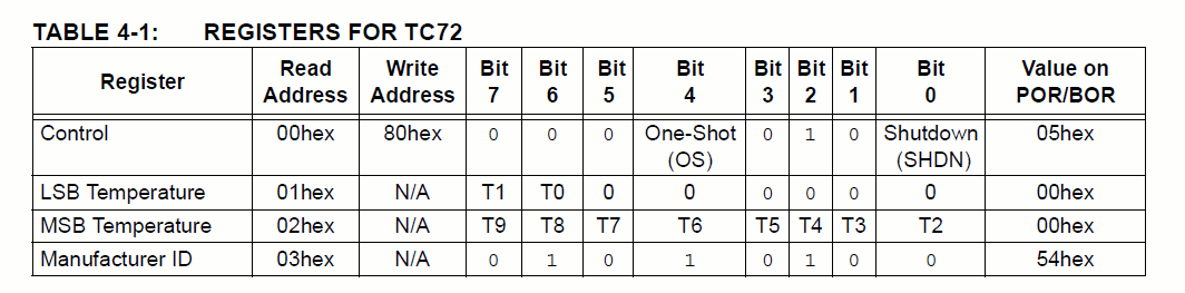

At power-up, the SHDN bit is set to ‘1’. Thus, the TC72
is in the shutdown operating mode at startup. The Continuous
Temperature Conversion mode is selected by
writing a ‘0’ to the SHDN bit of the Control register.
The One-Shot mode is selected by writing a ‘1’ into bit
4 of the Control register.
To start continous temperature conversion write 0x00 to 0x80. This clears all bits.
To do a one shot temperature reading write 0x10 to 0x80. This sets bit 4.
It is easy to get the bit numbers mixed up with the bit values. For example the value of bit 4 is 0x10. Rather then just using these values read the data sheet till they make sense. (Hey I could have muffed it).

Thanks for your reply.
I have tryied to write 0x00 in 0x80 :
SS=1;
SSPBUF=0x80;
while(!PIR1bits.SSPIF);
SSPBUF=0x00;
PORTB=SSPBUF;
SS=0;
But the confi register still with 0x05 value :/
Maybe my commands are wrong ?

The Chip Select bit in SPI devices is active low.
I think that the TC77 is better suited for bit-banged SPI. If you have or want to use the MSSP of the PIC, the TC72 is a better choice because it has a true SPI interface.
EDIT: I've noticed the 'tcc' spec (CE to SCK Setup) in the datasheet of the TC72; at high clock frequencies (>10 MHz) you might try adding a short delay after setting the CE bit?
