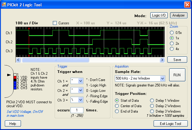

Here is an SPI routine that is not working - see attached analyzer log.
For some reason the Serial Out (SO) line (when high) is falling at clock rise but I can't figure out why. Any ideas? Perhaps it's staring me in the face because I've been debugging it for too long. Probably just need somebody else to have a look...

Any thoughts?
..or is it an electrical problem? Do I need any resistors or other components between the PIC12F675 and the ENC28J60? Currently it is a direct connection on a breadboard.

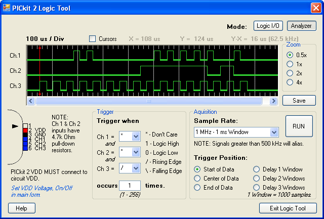

All fixed - I hadn't cleared the ANSEL register! See attached new analysis.
