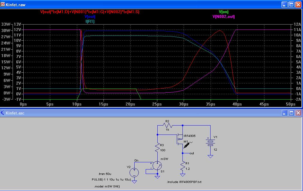

Starting out with 10 amps flowing through the FET to the lamps, Vsd is min, Vgs is max. Gate voltage is removed, gate charge starts do decrease, Ron starts to rise, current starts to drop, Vsd starts to rise. Max power dissipation happens as current and Vsd reach 50% of their max and the plots cross. The rising Vds probably effects the effect that the decreasing gate charge has by causing the FET act as if the gate charge was decreasing slower than it is and thus the knee on the plots.
I added the Vsd, V(N002,out) and the I(R1) plots which help me to see what happening a little better.
That how I see, am I close?
Thanks for the help and thanks for the lessons.

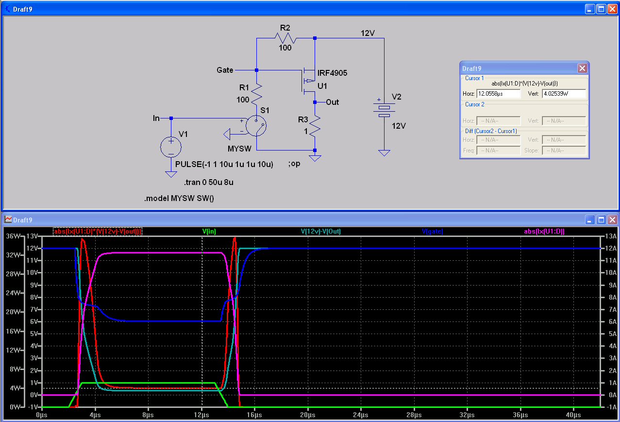

Given the value of R2 and the amount of gate capacitance noted in the datasheet, what does that imply to you vis-a-vis the gate charge you noted? Now run the same sim with R2 at 100 ohms vice 1k and see what happens to the power that must be dissipated.
Not sure what your asking, what you mean by "vis-a-vis", I assume run 100 ohms "vice" means "instead of" which bleeds of the gate charge quicker, but causes my sim to take for ever to run, but 110 ohms works fine. Also makes for a shorter period of power dissipation.
Kinarfi
Kinarfi
Sorry for the confusion. The French phrase vis-à-vis literally means face to face and refers to a relationship of one thing to another, a counterpart and/or a like function or characteristic, and vice can mean an exchange of one thing, value, concept, etc. for another.

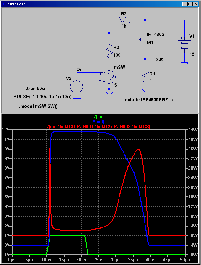

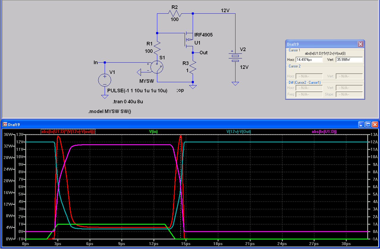

Below I have included two graphs with four traces; the trigger pulse V(in), the voltage drop across the MosFet V(12v)-V(Out), the absolute value of the drain current abs(1x(U1:D)) and the absolute value of the power loss of the MosFet abs(Ix(U1:D)*{V(12v)-V(out)}). One has R2 at 1K and the other has R2 at 100.
What I was trying to get you to see was the relationship between the gate charge and discharge and the resistance of R1 and R2. The gate charge and discharge period is the period of the greatest power loss as the device shifts from one state to the other. Graphing the drain current times the voltage drop across the device during the entire cycle displays the instantaneous power loss of the device over the period.
Note the extended time it takes for the MosFet to completely turn off as a result of the RC time of the gate capacitance and the value of R2 at 1K in the first plot and the very much abbreviated time with R2 at 100 in the second plot with relationship of the trigger pulse in both. Also of note is the delta in Ton in both plots.
I hope I have brought some clarity on the subject for you. Also, if you'd like the symbol file for the IRF4905 let me know and I'll post it.

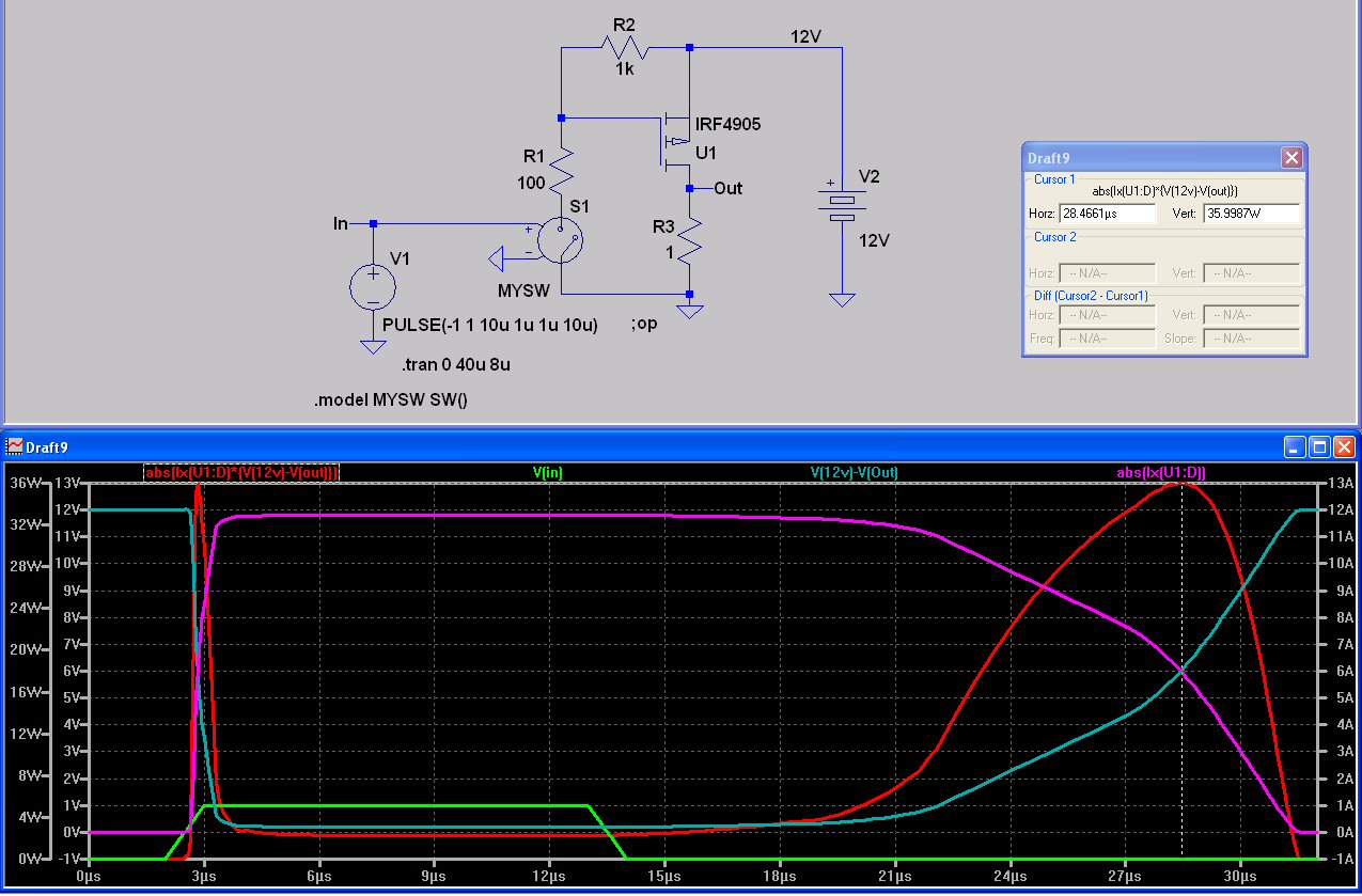

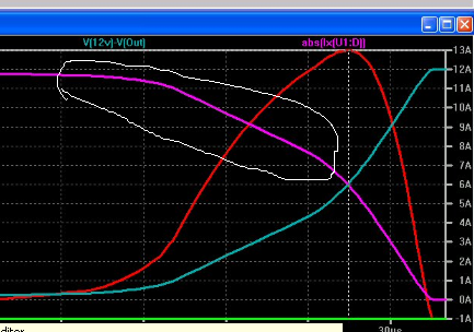

I understand the power dissipation during transition from on to off and off to on. Is my thinking that the the knee (circled in white on drawing) in the voltage across Vsd is do the change of voltage, Vsd, and acts as if gate discharge is decreasing slower than it actual is, assuming that is constant, Or does the gate discharge rate actually slow down? Or is it something else entirely that causes that knew?
Actually, the plot that you circled is the absolute value drain current. The V(12v)- V(out) plot is the voltage across the MosFet.
Think about it this way. Which terminal of the device controls Isd? To change the state of that switch, a charge, Q, must be pumped into and/or out of the gate to change the gate potential to change the conduction state. This essentially boils down to a RC circuit with the gate charging via R1 and discharging via R2. The rate of change of the gate potential is directly tied the rate of change in charge at the gate, which is the major factor impacting Ton and Toff.
Look at the datasheet below closely with particular attention to Fig. 5 and Fig. 13A.
https://www.electro-tech-online.com/custompdfs/2010/11/irf4905pbf.pdf

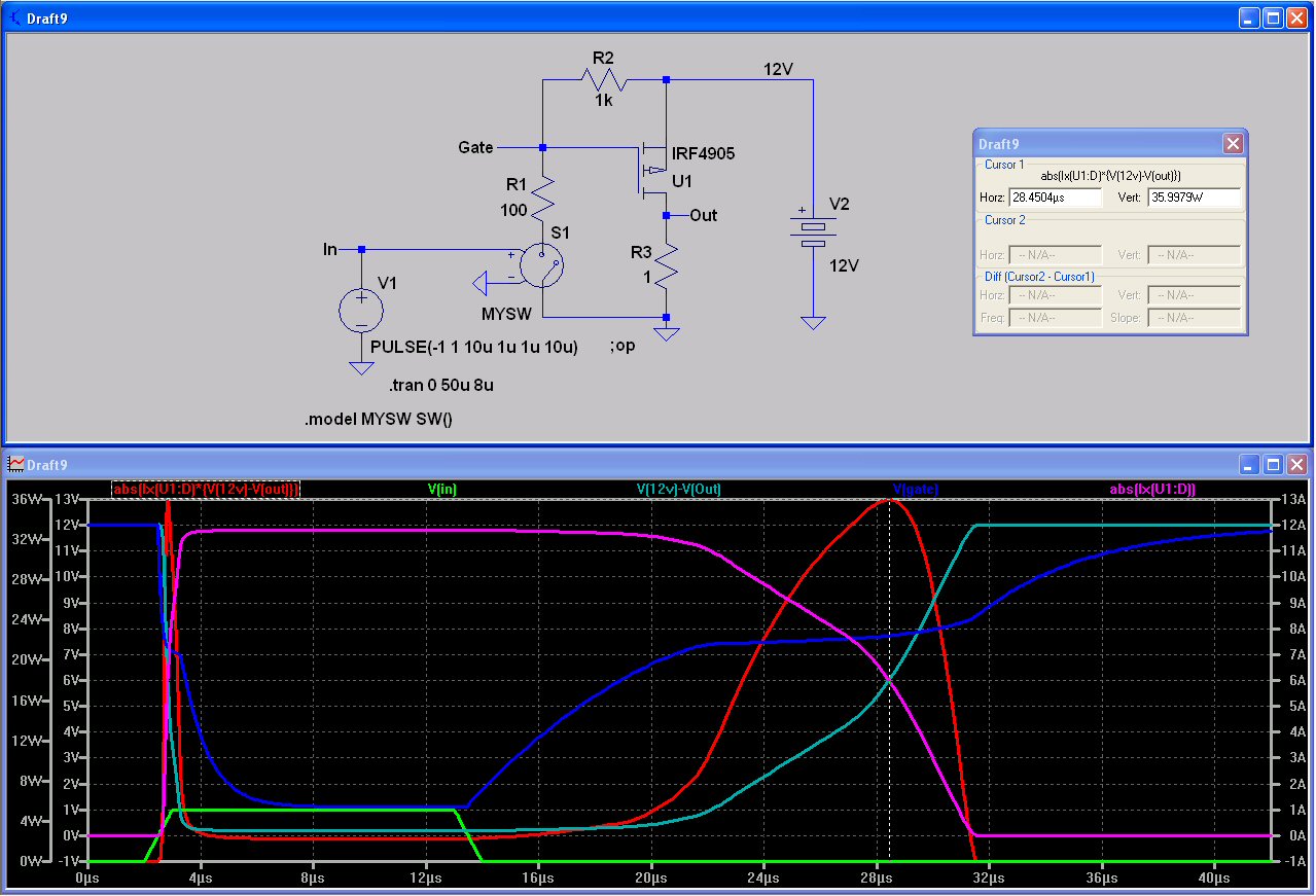

I have included two more plots with the addition of the gate potential V(gate) of those I posted yesterday. Look at the step in as the MosFet turns on and off and how that compares with the graph in Fig. 13A. Also, in the sim change R1 to 1ohm and R2 to 10ohms, and observe the changes in Ton and Toff.

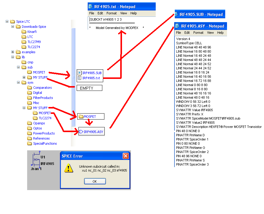

Most what I did worked but it failed to run, take a look at my files that I put together with copy and paste, hope it shows what is in which file in a method you can understand. Main question is what the ext is for the subcircuit file. I copied and saved it as a .txt file.
I appreciate your help,
Kinarfi

I used a new schematic, the IRF4905 came up beautifully, the IRF4905 was the only item on the page when I tried to run it and got the box at the bottom of the picture. What is the extension for the down loaded subcrkt supposed to be "IRF4905.txt" that goes into LTC\lib\sub\MOSFET
Just to be sure, I take your file, copy and save as IRF4905.ASY and put in new folder LTC\lib\sym\MYSTUFF\MOSFET
Then I take your file, copy and save as IRF4905.SUB and put in in LTC\lib\sub\MOSFET
Then I take my down loaded subcrkt file IRF4905pbf.txt and put it in LTC\lib\sub\MOSFET also.
Do I change the name to match the the others or leave it alone.

OK, I see what is wrong and why it isn't working for you. The line above that is highlighted and underlined is the problem.
The file I sent you is a SYMBOL file and belongs in one location only. For this instance, it should ONLY be in LTC\lib\sym\misc\MOSFET folder. It should NOT be placed in LTC\lib\sub\MOSFET as a sub file with a .sub extension.
To correct the issue, go to LTC\lib\sub\MOSFET and verify that that file begins with the line Version 4 using Notepad. If it does, delete that file. Then check the other file with the .txt extension you placed in that folder. If the first line reads .SUBCKT irf4905 1 2 3 that is the file that should be there. That file should be saved as IRF4905.sub because that is the subcircuit model file the symbol file is telling LTS to look for.
When you're done, you should have the symbol file I sent you in the folder LTC\lib\sym\misc\MOSFET with the extension .asy and with the first line reading Version 4, and the subcircuit file you downloaded from IR in the folder LTC\lib\sub\MOSFET with the extension .sub and with the first line reading .SUBCKT irf4905 1 2 3
Make those changes and it will work fine for you just like components LT supplied in the program. Let me know how it turns out.
Worked like a charm.
IRF4905.ASY goes into C:\Spice LTC\lib\sym\MY STUFF only
IRF4905.sub which is downloaded from the manufacturer as a .TXT file goes into C:\Spice LTC\lib\sub only
after I remove MOSFET\ from the line SYMATTR SpiceModel MOSFET\IRF4905.sub in the IRF4905.ASY
already did this & it works!!
Seems simple, just hard to find, understand and implement. Been trying to add components for a long time and this is my first success.

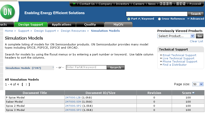

Trying get a good model for a 2N7000 and others, went to ON Semiconductor and got 4 of them, which one do I want for LTSpice? Do I cut it out of the models they show and paste it?
This is the first model in C:\Spice LTC\CMP\standard.mos. AO6407 VDMOS(pchan Rg=3 Rd=14m Rs=10m Vto=-.8 Kp=32 Cgdmax=.5n Cgdmin=.07n Cgs=.9n Cjo=.26n Is=26p Rb=17m mfg=Alpha_&_Omega Vds=-20 Ron=34m Qg=13n)
When I get the 2N7000 model, I will just copy and paste it at the bottom or top of Standard mos.
Is this correct?
Kinarfi

This is the one I use from Yahoo user group
  • 2N7000.zip
Hi kinarfi,
Yes that is the method I use when I have a valid model file, unlike the method we discussed last week where only the .subckt file was available. One caution I will pass on is to follow the same format used in the standard.mos folder for any device you place in there. For instance, if the device is a p-channel be sure that appears as the first annotation after the open paren of the model and for n-channel it is omitted. Be sure to get the manufacturers name added and Vds, Ron and Qg from the datasheet in the correct order ending with the close paren. Be sure you save the file (standard.mos) rather than save as with another or misspelled name. Before closing down NotePad, reopen standard.mos and insure your new models are there...jusssst to be sure.
Or you can use the subckt file Eric has provided for one of the devices, and you know how to do that now.
