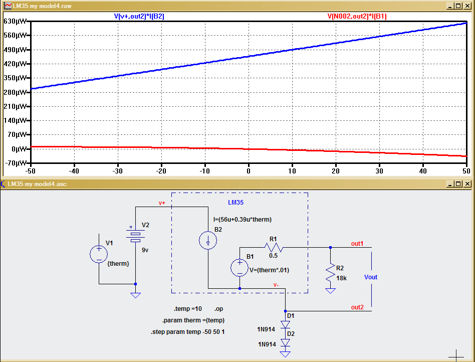

Anybody have these? I have created crude behavioral models, but would like something that would model power consumption. The one on Yahoo's LTSpice forum is no better than the one I made.
This my variation of a Yahoo model, I add the diodes when using the LM35 below +2Cdeg.
Posted in case you dont have the original model.?
