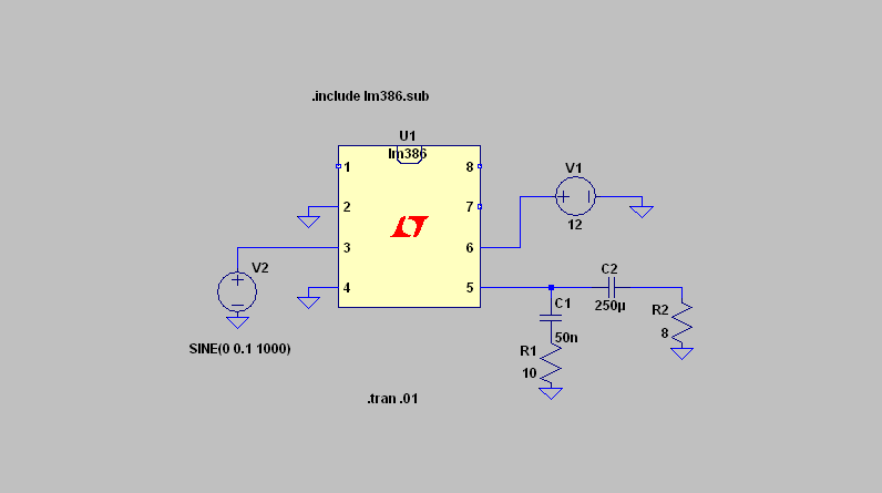

I'm trying to simulate a circuit with a LM386 with switchercad, and since that IC isn't defined in the programs library, I looked up a spice model on the net. The problem is I cant seem to get the whole thing working. This is what I do:
I saved the spice model in a file called LM.lib in \lib\sub . The file is attached.
I placed a 8 pin din, and entered the following fields:
Prefix: X
InstName: lm386
SpiceLine: .INCLUDE LM.lib
Now, when i try to run the simulation I get the following error:
SPICE Error
Unknown subcircuit called in:
xlm386 n002 n001 n004 0 p001 n003 nc_01 n002 .include lm.lib
what am I doing wrong?

Use the SPICE directive '.include lm386.sub' (check the filename!) to specify the model. Be sure you've re-started LTSPICE.

I usually use a SPICE directive (menu 'Edit'->SPICE directive). Type 'include lm386.sub' in the edit box and place the label in the schematic.
geez... nothing seems to work. I've tried everything, exactly as it says in the posts. I also tried using another lib-file, just to see if there was something wrong with the one I tried, but the same error message. I wonder if the path isnt found?
I've just gone through the same steps and the simulation runs with no errors.

I've tried to cancel the 'include' directive and I've got the error message.
It seems that the program can't find the file in your computer. There must be something wrong with the file name or its extension or paths as you said.

This is my schematic, if it helps:

Now it works. Using the full path to the sub file and realising (thanks to your schematic) that I had put the model name in the wrong field, made it work.
