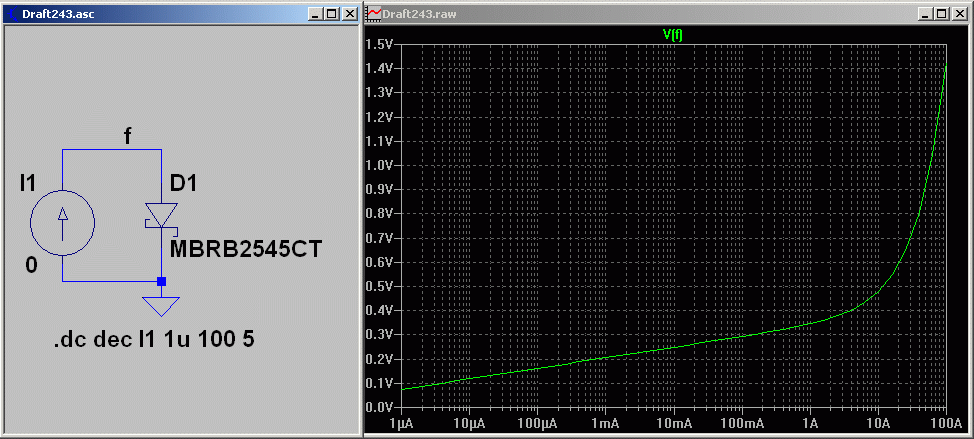

This one, which is part of the standard.dio lib in the release, is probably close enough...
If not, copy out its .model parameters, and tweak the ones dont like...
.model MBRB2545CT D(Is=19.4n Rs=.01 N=.733 Eg=.718 Xti=.535 Cjo=2.05n Vj=.4 M=.41 Iave=25 Vpk=45 mfg=GI type=Schottky)

How accurately do you need to model that big diode?
Whatever you come up with should closely follow the I/V curve I showed you back in post #2.

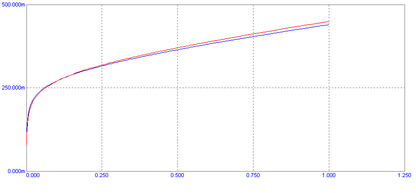

Hello again,
In post #10 i gave you a formula for calculating Is as that's the hardest one to solve for. Once you have Is, you can insert that into the diode equation and solve for N and Rs, or just solve for N and Rs and insert Is later:
N=(Id1*Vd2-Id2*Vd1)/((Id1*log(Is+Id2)-Id2*log(Is+Id1)+Id2*log(Is)-Id1*log(Is))*Vt)
Rs=-(log(Is+Id1)*Vd2-log(Is)*Vd2-log(Is+Id2)*Vd1+log(Is)*Vd1)/(Id1*log(Is+Id2)-Id2*log(Is+Id1)+Id2*log(Is)-Id1*log(Is))]
These two provide the N and Rs constants. Note again log(x)=ln(x) here.
Points Id1,Vd1 and Id2,Vd2 can be any two points on the original curve, but since we needed three points to solve for Is we can use two of those points, or measure two more sets.
In the attachment, the blue plot is the original diode and the red plot is the diode curve obtained by extracting three point values from the original diode curve. You can probably get even more accurate if you are more careful with the measurements, but you can see how similar they are already.
Id is along the horizontal (0 to 1 amp) and Vd vertical (0 to 500mv).
The original diode was a Schottky type diode, where sometimes two diodes in parallel are used. But you can see they are pretty similar using just one diode (red curve) to model the two in parallel (blue curve).
