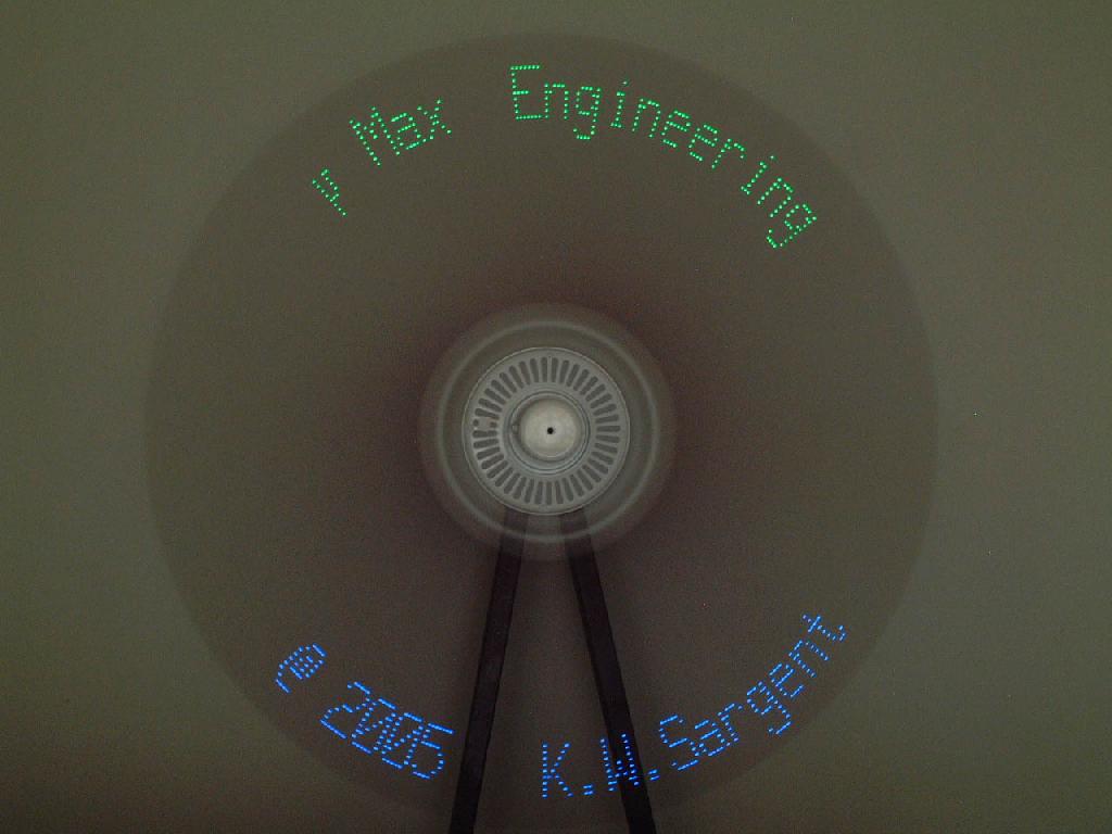

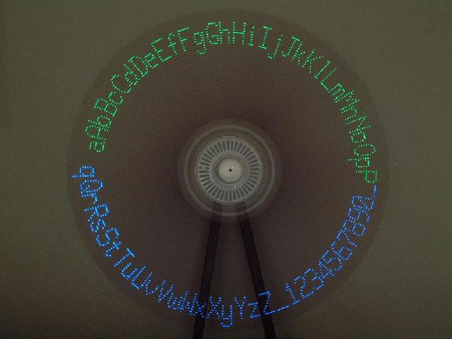

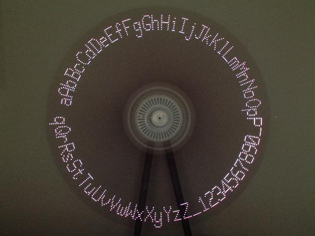

Graphics? I'll 2nd birdman: a big table, unless it's repetitive and/or symmetrical. Mine is built into a ceiling fan and spells messages. It took a solid month for me to get the code right, partly due to lower case descenders in the upper vs lower arc. The "static" pix (see attachments) are time lapsed, the .avi is from a camcorder.

For real lower case descenders, 15 LEDs are used in a 7 X 12 character matrix, the "floating" 3 are the descenders for the opposite arc. This is so the upper case matrix stays spatially stable. Controllers are a pair of Freescale 908 series. One runs the text->output w/offset & color changes through constant current drivers to the RGB LEDs. The other manages the messages to be displayed and the comm link to the programmer.
The "blade" software runs upper & lower arcs of 32 characters each and allows for full rotational offset. There're also color toggling aspects on a # of rotations/change basis. It's all I could do with the RAM available, an updated 9S08 version could do a Lot more. It runs in both rotations & all 3 speeds (index pulse timing checked every rotation & corrected as necessary). The programmer is a Windows VisualBasic application.
Generating the font tables is straightforward, outputting the formatted data is easy. You'll earn your stripe in reading/formatting the text for output. It requires both forward & reverse table use and inversion with vertical offset. I found it a Real brain scrambler. Good Hunting... <<<)))
