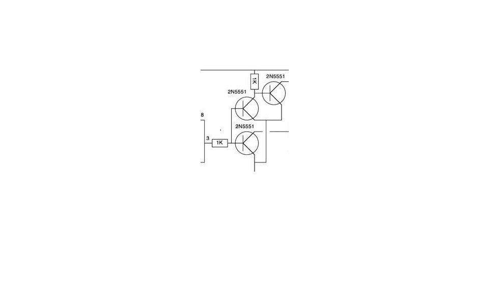

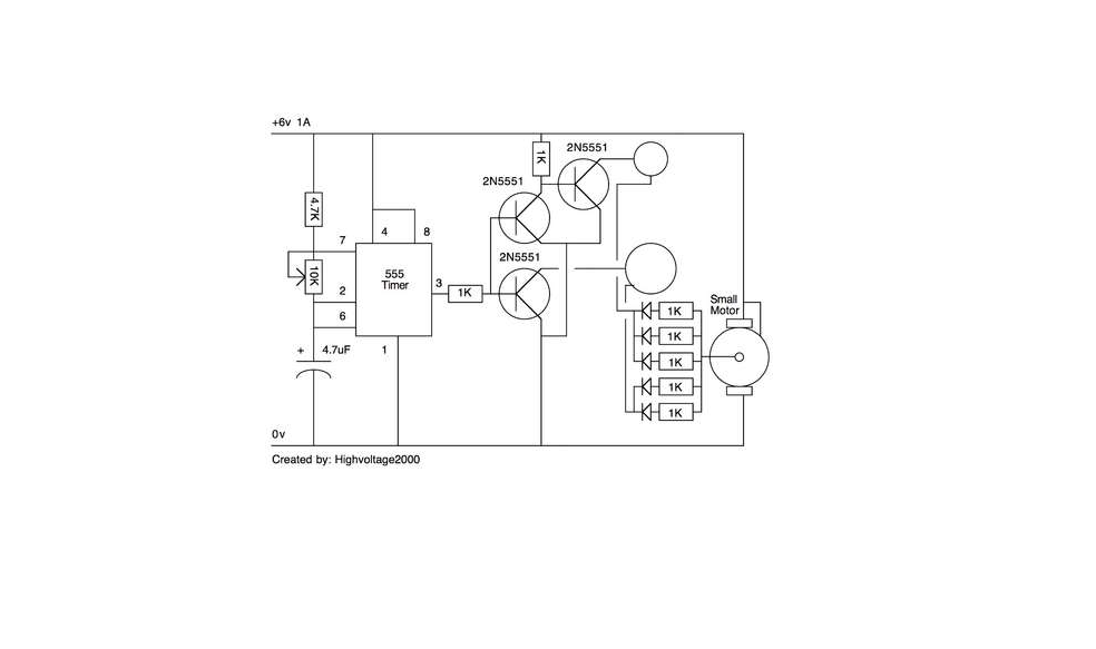

When the output of the 555 is high, the bottom transistor turns on two of the led's (supplies 0v).The middle one interrupts the current flow to the third.
when the output is low the bottom and the middle transistors are off so the third turns on the other three led's
