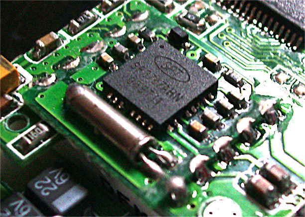

I mean im sure i can make a adapter in eagle in like 2 minutes. and make it a SMD addon. Like the below picture . I love these SMD devices:

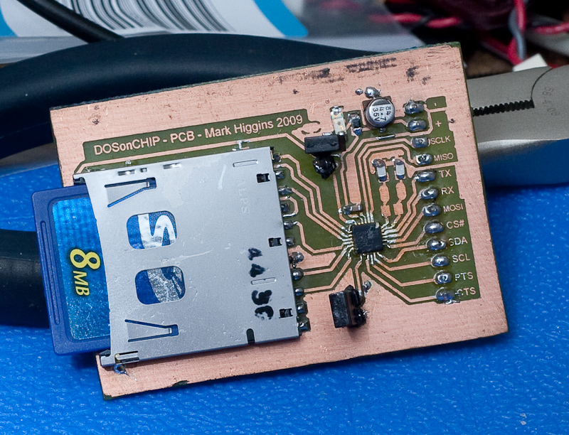

I have the DOSonCHIP and I don't care for it. It's slow and if I want to use this stuff on more than one project I have to buy more chips. There's no actual protocol documentation for the DOSonCHIP, they tell you to look at the API that they wrote in C, if you want to find out how to use the chip. Heck, if you want the breakout board and chip that I made up you can have it.

The DOSonCHIP breakout I made. It's already conformal coated, and I never bothered putting the time keeping crystal on it. The chip was soldered/unsoldered a few times, which is why it looks a mess. I kept thinking it wasn't sitting properly because I wasn't getting the right data from it, just garbage, then I found out the latest version of the firmware only supports a command packet structure, which is different than the original documentation they put out shows.
