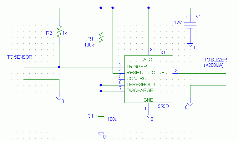

I'm getting lawn sprinkler leaks, and I'd like to know exactly when my water in the irrigation system is flowing. I don't care how much is flowing, just an ON/OFF signal.

Like I said, I really just want ON/OFF, YES/NO.. so I can control a light or chirping buzzer with a relay or something.
Is there a fairly easy way to:
- send it power? 5V? 12V
- Determine that ANY "a low impedance signal" is being sent?

It looks like the sensor makes pulses of low impedance (15R + 0.7V) as the rotor turns. If you want to detect any single pulse and turn on a buzzer, you can try the attached cct. Any detected pulse triggers the LM555 timer IC, which sends ~12V to the buzzer for ~11 seconds after the last pulse.

Dougy, that's awesome.. thank you... so I guess that follows two questions:
- as the next poster said, will this detect very low flow? Typically when it leaks, it leaks big, but it might leak small, I just don't know....
- this is supplying power to the unit as well you think? Is that what this means "Power to operate the sensor is provided by the flow monitor"?

From the quick look I had at the datasheet, it looks like the sensor is supplied current through its 2 wires, and will short-circuit (connect a low impedance between them) them every time it outputs a pulse. Power is supplied from the 12V supply through the 1k resistor in the above diagram. EDIT: Be sure to connect the sensor around the correct way: + to the 1k resistor, - to the 0V.
From the datasheet, it says the sensor is 1% accurate for flow rates of 0.5-30'/sec. I can only guess that it will work outside this range with varying degrees of accuracy. Obviously I have no idea of how small a leak can be detected.
