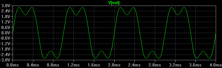

For fun, I once made a "first and third" generator, whose input was a sine wave and whose output was a waveform which was the fundamental plus 1/3 of the third harmonic. The idea was to generate the first two terms in the Fourier series expansion of a square wave. I did it with two analog multipliers (LM1495's, now extinct), and maybe an op amp (I can't remember - this was circa 1970).
The key identity is
sin 3(x) = 3*sin(x) -4*sin^3(x).
I then had to add 1/3 of that to the fundamental. The first multiplier generated sin^2(x), and the second one took sin(x) and sin^2(x) and generated sine^3(x).
You can do this with a filter, but it will only work at one frequency unless the filter is tunable, such as a switched capacitor filter. I don't think they were available in integrated form in 1970, and besides I probably wouldn't have understood them then.
Below is what the output waveform looked like.
This is obviously the rambling of an old fool. :)

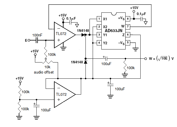

yes I saw that circuit before, I want to use it but my circuit is working with 12 to 15V there is no NEGATIVE voltage for this square rooter,
I bought few 633 IC's few months ago for 5 or 6$ but did not use them yet,
Anyway the power supply is not able to generate any negative voltage, is there any way to convert or modify this circuit for a common power supply?
I need it for a kind of audio amplifier and want to get a square root from its ouput signal, to remove or limit kind of noise.

This circuit just creates an "artificial GND" at VCC/2, similar to many single-supply op amp circuits.

Ron H said:
OK, if you say so...
Ron,
Thank you very much for the circuit.
most of opamp circuits I have seen use TL072, I have no access to it, can I use LF411 or LF351 instead?
I think the answer is yes because it seems there is no difference rather than freq response and..
I"ll try to make your circuit tomorrow, hope to get a good result with it on audio freq.

Ron, I made it, there is a problem, the output voice is not so clear(cut cut or something like that is in the voice) like when the dc voltage of an amplifier is not perfect?!
Do you have any idea?
perhaps we need to make more modification?
1. You won't be able to understand the square root of audio.
2. If you don't have the offset pot set high enough, I think some sort of clipping will occur. The op amp offset voltage should not be important, since this is an AC-coupled application.
