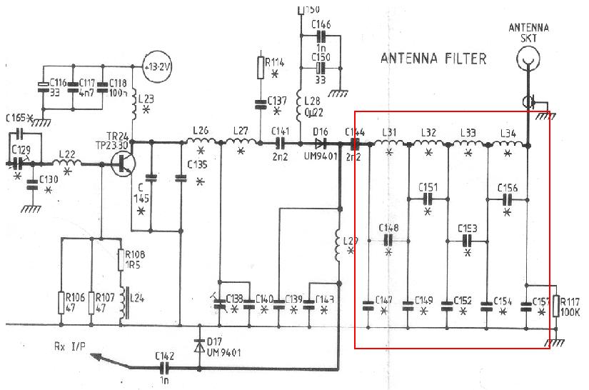

In a real world radio transmitter, there are several ways of producing the final output frequency.
The aim of the designer of the transmitter is to minimise outputs on unwanted frequencies. Most often these outputs will be on frequencies which are harmonically related to the required carrier frequency.
To remove the harmonics (and any other unwanted output which is above the carrier frequency), a low pass filter (LPF) is used.
Depending on the amount of harmonic suppression required, the LPF may have many sections of inductors and capacitors often configured in a "pi" arrangement.
Have a look at the attachment which shows such a filter. (Highlighted in red).
This type of filter is usually referred to as an elliptical filter.

Hmmm .... yes, sort of.
I do not see the speaker output ???
Why would you expect a speaker? It's an RF transmitter under discussion!
